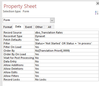

Doug Robbins - MVP - Office Apps and Services 323K Reputation points MVP Volunteer Moderator
2019-01-16T05:54:08+00:00
Try with the Recordset Type changed to Dynaset (Inconsistent Updates).

2 additional answers
    2019-01-16T20:35:49+00:00
    That fixed the update issue I was having. Thanks Doug

    2019-01-14T19:40:48+00:00
    Thanks, Duane.
    Yes, [Translation Priority] is a numeric field. Your code works, but I can't update the field. I CAN update other fields in the form. When I take out the ORDER BY entry, the sequence is incorrect, but I can update the field.
    Here is the Property Sheet for the subform. See anything obvious?
    (Don't worry that "Priority" is missing the final "y"  That is correct.
