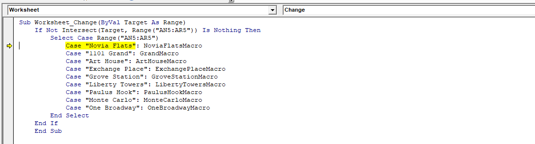

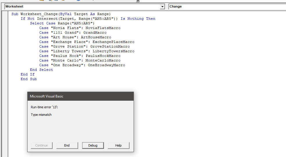

Hi, I am trying to run some macros based on the value that I choose from a drop down list.
If I run the macros by themselves they all work perfectly, but when I try to make them run out of a list with the same names and everything it does not work. And I really do not know how to fix this.
This is the code I am using and here are the pictures of the error I get. I get it while changing the value on the list or simply by deleting the value on the cell.
Sub Worksheet_Change(ByVal Target As Range)
    If Not Intersect(Target, Range("AN5:AR5")) Is Nothing Then
        Select Case Range("AN5:AR5")
            Case "Novia Flats": NoviaFlatsMacro
            Case "1101 Grand": GrandMacro
            Case "Art House": ArtHouseMacro
            Case "Exchange Place": ExchangePlaceMacro
            Case "Grove Station": GroveStationMacro
            Case "Liberty Towers": LibertyTowersMacro
            Case "Paulus Hook": PaulusHookMacro
            Case "Monte Carlo": MonteCarloMacro
            Case "One Broadway": OneBroadwayMacro
        End Select
    End If
    End Sub
2018-10-13T02:27:01+00:00
I would suggest similar to this construct where AN5 is a DV List to choose from.
    If Not Intersect(Target, Range("AN5")) Is Nothing Then
        Select Case Target
        End Select
    End If
End Sub
Sub NoviaFlatsMacro()
    MsgBox "NoviaFlats 12345"
End Sub
Sub GrandMacro()
    MsgBox "1101 Grand 67890"
End Sub

2018-10-13T01:33:35+00:00
Hi CarlosRdrz,
Are you sure that you want to check the range of 4 cells for one entry?
What cell is linked to your drop-down list?

    2018-10-13T02:58:47+00:00
    Thank you Gord, your suggestion helped me fix the problem as well.
    2018-10-13T02:58:19+00:00
    Hi Jason,
    Thank you for your question, at first I did not get what you were trying to ask be, but when I thought about it a little bit, I just left the first cell of the range I was watching (AN5) and it all works well now.
    Thank you for your help.
