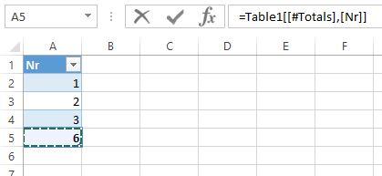

I'm trying to reference a column total from a table that's in another sheet and it's throwing a "There's a problem with this formula error" . The formula I'm using for that is =TableName[[#Totals],[TableColumn]], I have checked the table and column names and they seem correct. Am I doing something wrong? Is there another way to do that that's not using a direct cell reference?

Do as follows:
In your sheet type a = into a cell (do not press ENTER)
Switch to the other sheet
Click into the total cell, then press ENTER
Andreas.

    2018-09-06T14:37:22+00:00
    It just worked, oddly enough, considering i tried that before and it gave me a direct cell reference. Looks like the problem was i was using a comma instead of a semicolon. Thanks!

    2018-09-06T14:32:05+00:00
    If i try clicking on the cell it gives a direct reference(Sheet1!B8). I typed it with the help of the formula auto completion.
