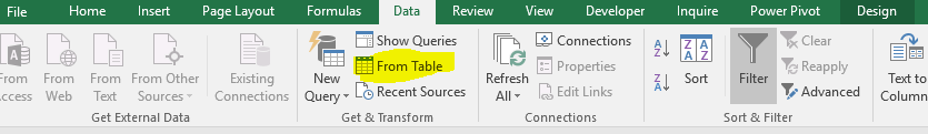

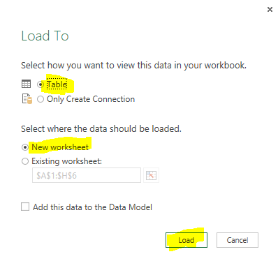

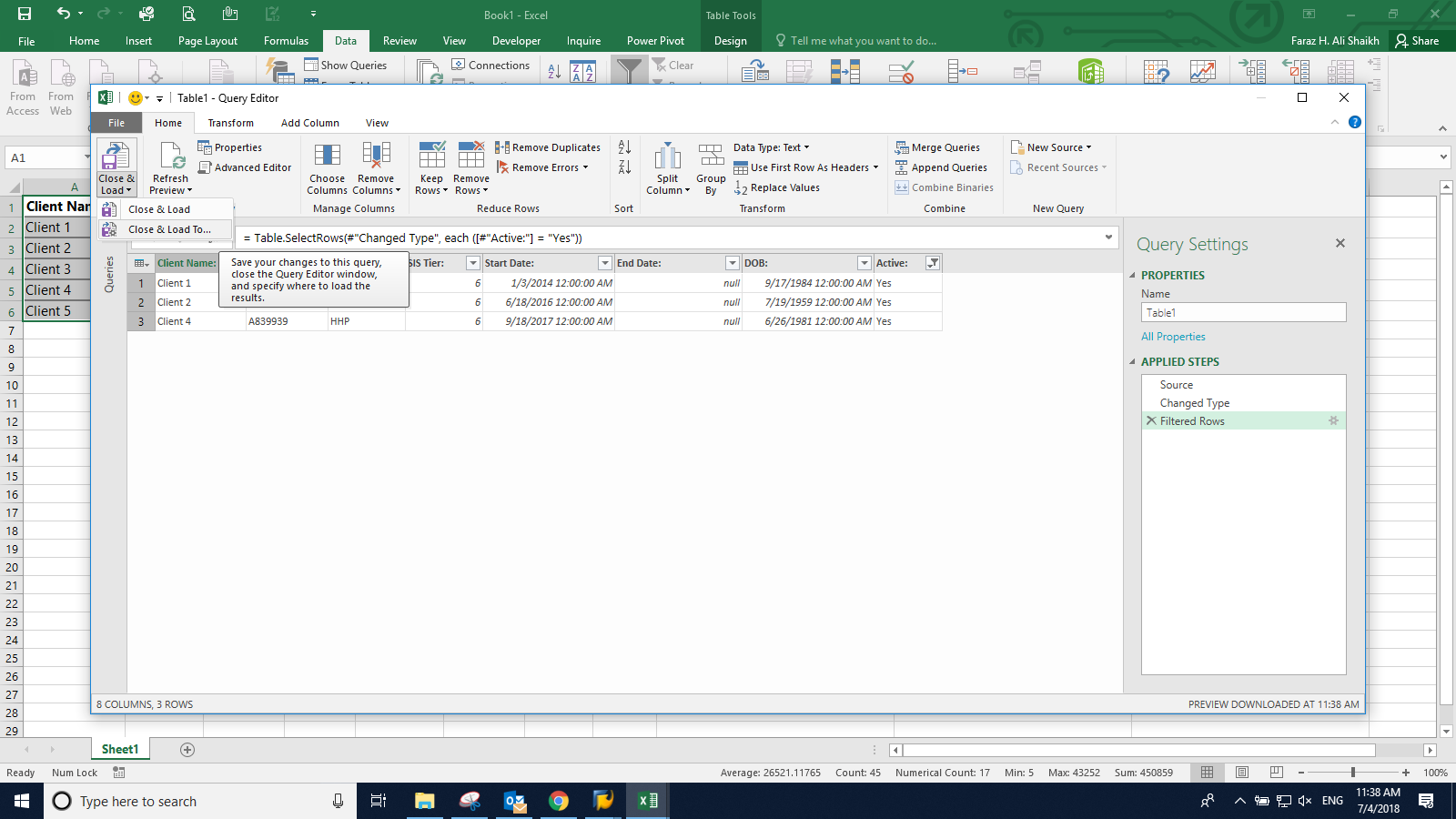

    2018-07-04T08:34:16+00:00
    Dear Friend,

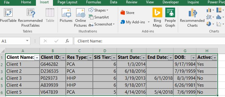

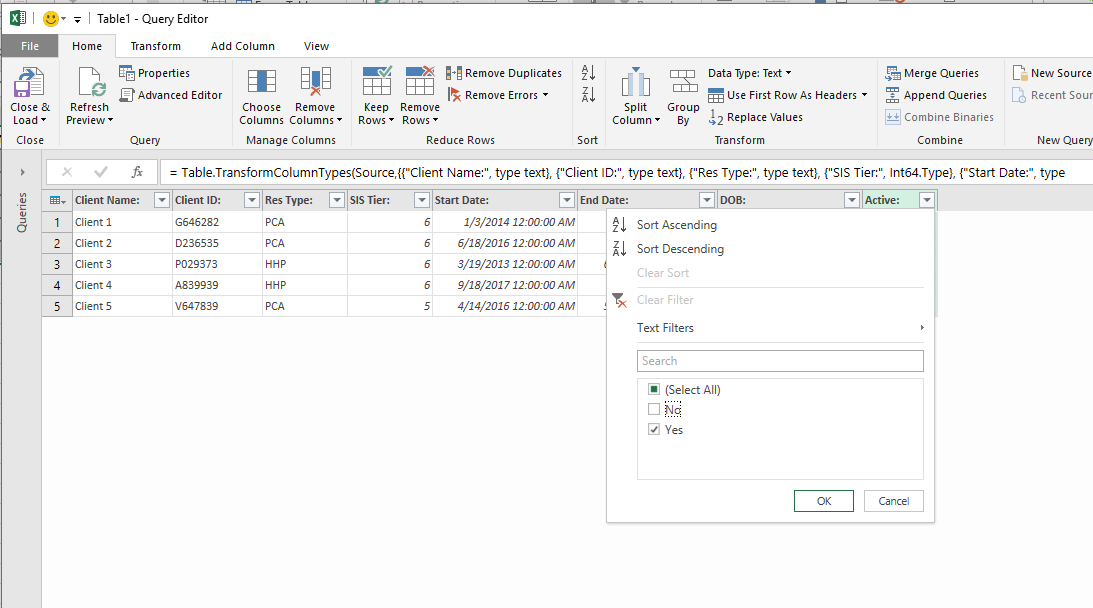

    i would recommend you use the PivotTable or the PowerQuery for your issue, that is the easiest and the simple solution for your issue
    Incase of PivotTable - Select the active status and check only "Yes"
    Incase of PowerQuery - Convert your data to table range and Select the active status and check only "Yes" - Select Close and Load to - new sheet. as you make charges it will reflect on the new sheet

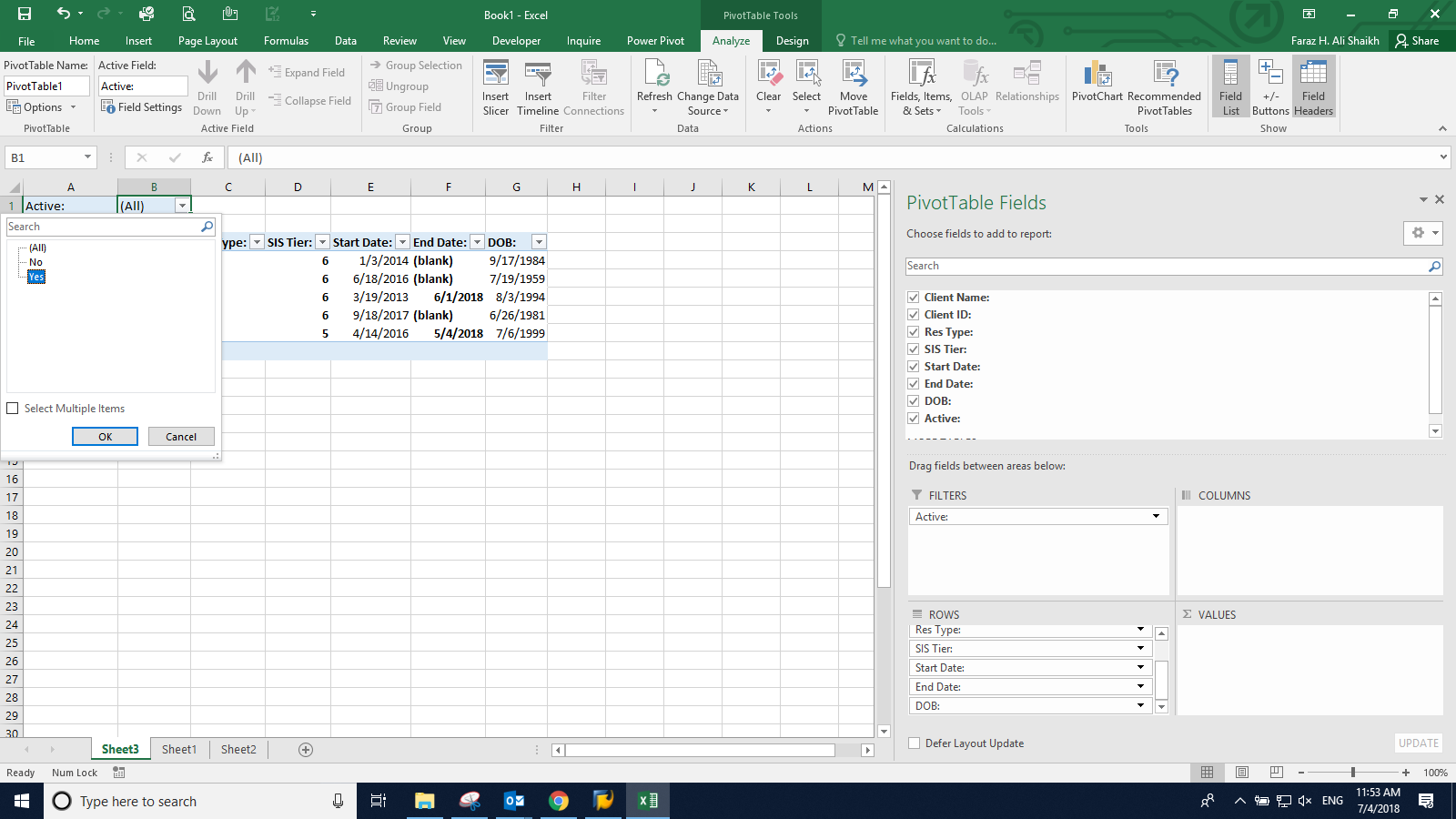

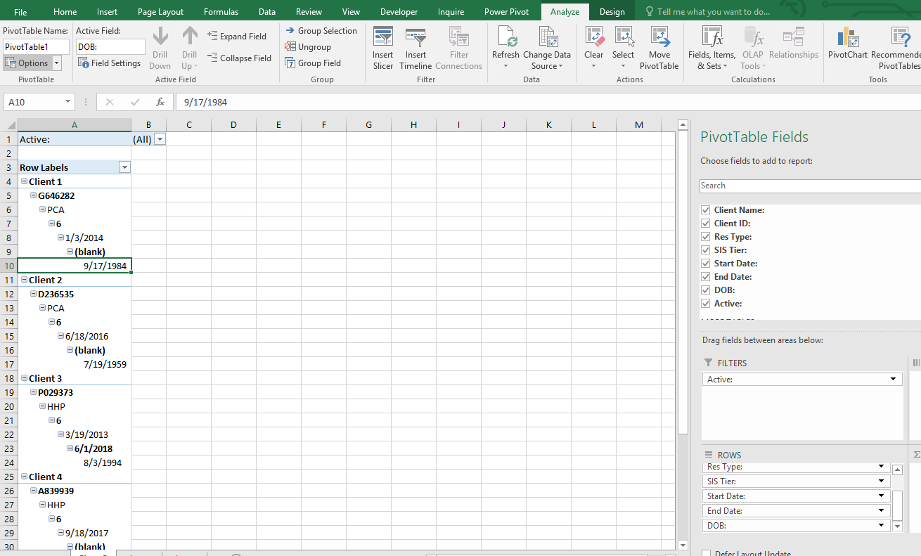

    2018-07-04T08:59:38+00:00

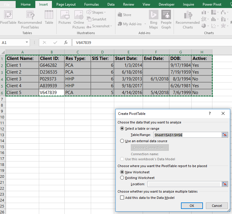

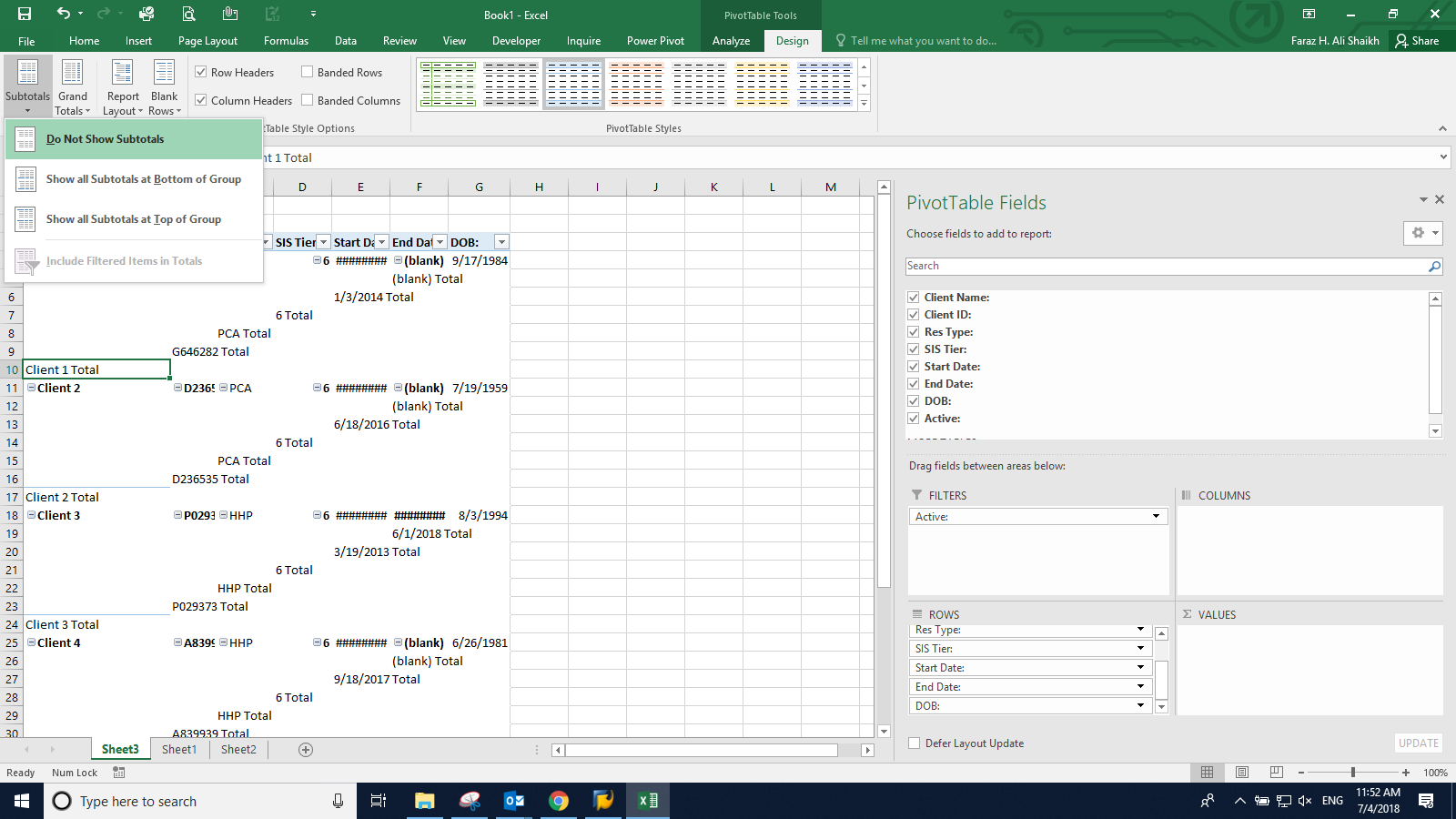

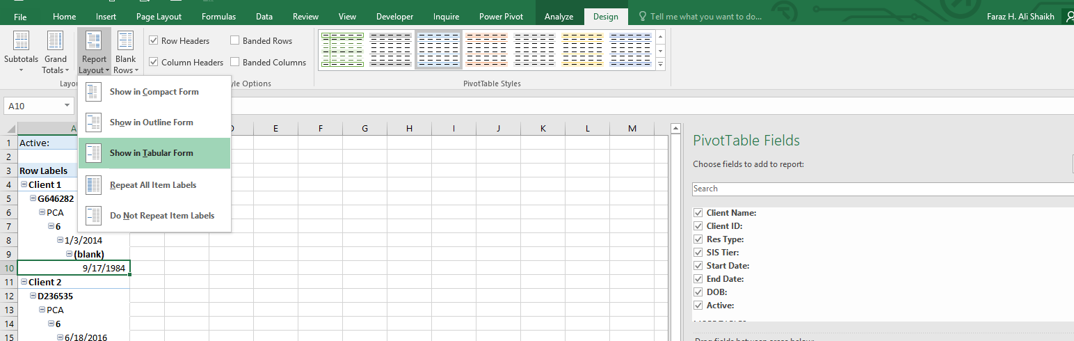

    Dear Friend,
    please find below the solution for the PivotTable and follow the steps as below
    recommend you to change the data to table range
    Add all the fields to row area & active field to filter area
    select report layout
    Remove all the subtotals

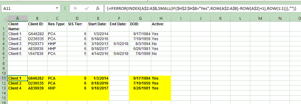

  5. Anonymous
    2018-07-04T09:07:31+00:00
    Enter below formula as an array formula (Ctrl+Shift+Enter) in cell A11 and copy down and to the right (except column F):
    =IFERROR(INDEX(A$2:A$8,SMALL(IF($H$2:$H$8="Yes",ROW(A$2:A$8)-ROW(A$2)+1),ROW(1:1))),"")
