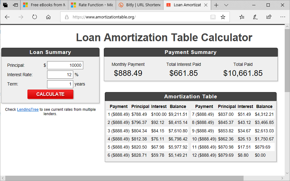

Also please explain how this principal 788.49 is calculated from below table

    Also please check how this principal of 788.49 is calculated
    As I explained previously, if we assume an interest rate of 1% (instead of a payment of 933.33), the monthly payment is calculated as PMT(12%/12, 12, -10000) = 888.49.
    (Previously, I wrote 889.49, an obvious typo, which you could have discovered by entering the PMT formula yourself.  It is also demonstrated by the online loan calculator that you show.)
    And if the interest rate is 1%, obviously the first interest amount is $100, namely 1% of 10,000, leaving 788.49 to apply to the principal.

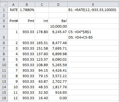

    The point, again, is:  if you assume that the payment is 933.33, it changes the interest rate to about 1.7880%, as I demonstrated previously.
    But if you assume that interest rate is 1%, it changes the payment to 888.49, as I demonstrated previously (but with a typo; sorry!) and as you demonstrated with the online loan calculator.

    Your first mistake is in thinking that 933.33 is the correct payment for a monthly interest rate of 1%.
    To demonstrate the correctness of the RATE result, see the following amortizations schedule.
    For an interest rate of 1%, the monthly payment is 888.49 [*]:
