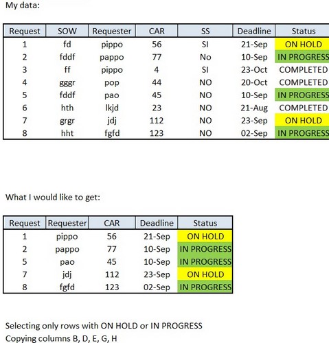

    2018-09-24T18:49:26+00:00
    Here is a picture too, hope it helps

     KERATL, thanks for getting back to me.
    I should have provided more info at first place, especially considering my almost non existent expertise in VB. :(
    Please find attached a clear example of what I would like to get from the script. It's an example, not my real data.
    You can find the excel file here
    https://files.fm/u/xv892rt4
    2018-09-24T11:43:22+00:00
    Replace
                rngCells.EntireRow.Copy wsDest.Range("A" & DestNoRows)
    With something like
    wsDest.Range("B" & DestNoRows) = wsSource.Range("A" & I)
    wsDest.Range("C" & DestNoRows) = wsSource.Range("B" & I)
    wsDest.Range("F" & DestNoRows) = wsSource.Range("C" & I)
    replacing the A, B, C on the right side with the correct source columns, as those were not specified in your post
    This is just aircode, tweak as needed
