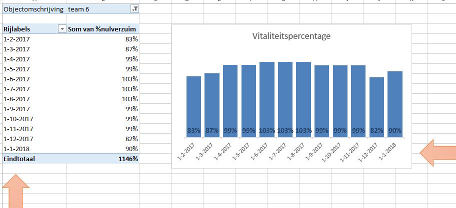

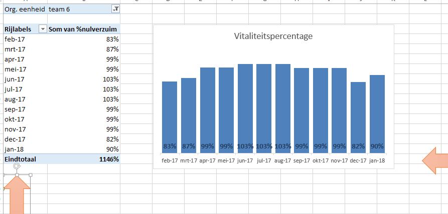

I have an issue with dateformat and sorting months in a pivottable.
I have created a sample file with two pivot tables in it (sorry its in Dutch).
  • one WITHOUT adding to the data model => shows the months in the correct format (JAN FEB etc) and correct sequence
  • one WITH addition to the data model => does not show the months as a three-letter abbreviation, but as a date format with the first of the month as the day (1-2-2017, 1-3-2017, etc.)
The data table is filled with data that directly from an ERP system.
What I can not figure out is how to get the date format right when I add the pivot table to the data model.
I need that because there are multiple pivot tables in the original spreadsheet based on multiple data tables. These are all linked (relationship) to organizational unit.
With that, I can adjust all the graphs at once to the selected team with one slicer.
I'm curious if anyone has an answer to this.
I work with Office 2013, without power BI and without power query.
I have created a model but can not add it here.
I just add two screen prints to show the diffference.
One when I add the pivot to de the datamodel and one without adding the pivot tot the datamodel.
The one I want to see is the formatting  als in the model without adding the pivot tot the datamodel.
What do I have tot do to get the pivot added tot the datamodel and showing the celformatting of the months as a three letter abbriviation?
Pivot WITH adding to datamodel.
Pivot WITHOUT adding to datamodel.
