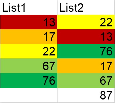

Hello and good day. I need help with the following.
I have two separate lists (columns) filled with numbers. The number of rows is different for each list and the values of each row is different from the other column. However, most values of List1 match with those in List2, just not in the same row. Refer to the following image.
The goal I'm trying to reach is to compare the values of List1 with those of List2, in descending order, have the equivalent values highlighted, BUT have each highlight be of different color, preferably in the RGB color order or by hues (or any other order you may know of, I need ideas). Refer to the following images.
                   ![](https://learn-attachment.microsoft.com/api/attachments/79fc710e-96e2-4c42-a0b9-ed79021d616b?platform=QnA

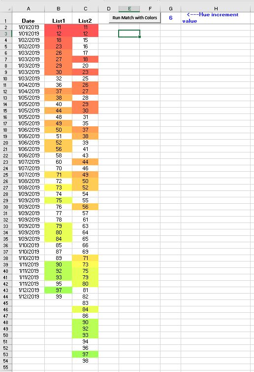

    Try the code below. I have used cell G1 on the worksheet so you can change the Hue increment value and it makes it easy to experiment with. You will see in the code where I have indicated that you can hard code the increment amount.
    HSL colours are not directly supported in VBA so it is necessary to convert them to RGB. There is a UDF that I obtained from elsewhere and the link to it is at the top of the UDF. Worth going to the link and read a little more about it. You will see that I edited the UDF at the bottom of it to return an array in lieu of a string and the array elements are used to set the RGB color.
    Screen shot of my test worksheet. I have zoomed it so I can get as much as possible on this post.
    From your previous post I am assuming that you know how to install and implement the code. However, feel free to get back to me if any questions.
    VBA code below the screen shot. (Amended screen shot)
    Following code has been edited since initial posting. The called sub has been removed and now the RGB array is only created once for each time the colour is changed which reduces the processing because it reduces the number of calls to the UDF.
    An example workbook has been uploaded as a zipped file to the following link. Download and unzip the file.
    https://1drv.ms/u/s!ArAXPS2RpafCnjNEQVlqBEQsEjSn

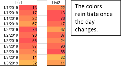

    Hello Mac, thank you for replying.
    "How do you define this color order with three different values for R, G and B?" What I meant was to establish each cell to follow the next order of color:
    You are correct, I thought there may be a pattern between the RGB values that could be set through macros, but after playing around with it on the “Colors” window in Excel, it now appears to complex to identify such patterns. However, when I switched to the “HSL Model” it seems that such order could be easily established by just increasing the value of “Hue” in multiples of 6, leaving “Sat” as 255 and “Lum” as 170 without changing them.
    ![](https://learn-attachment.microsoft.com/api/attachments/90b247a3-b19a-45a7-9d3c-84851e49cc28?platform=QnA"https://learn-attachment.microsoft.com/api/attachments/dc3c3fba-c273-422f-9df6-e7a6577b949f?platform=QnA" rel="ugc nofollow">
    Finally, the multiple 6 (referred in the 2^nd^ paragraph) is chosen since there could be up to 50 matches per day. However, the “H” value in the “HSL Model” reaches a limit of 255, hence the macro needs to include a condition that restarts the “H” value once it reaches 255, even if it's on the same day.
