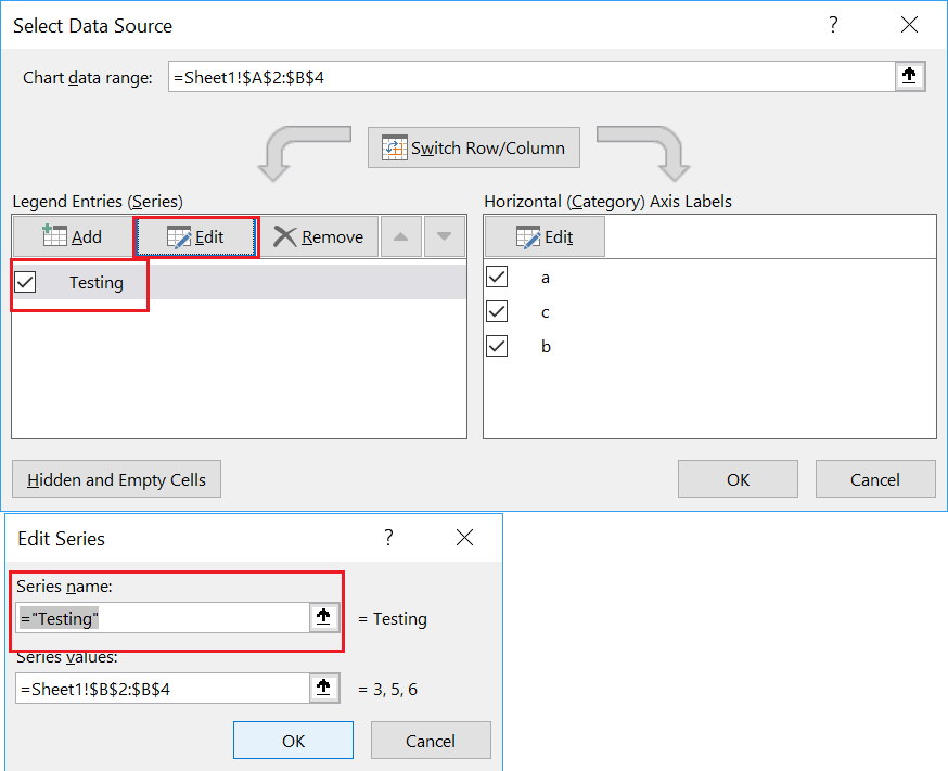

You can right click on legend > Select Data > In the left pane, select your Series name and press Edit button > Give it a new Series name here which will change your legend also.
