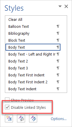

  4. Charles Kenyon 159.8K Reputation points Volunteer Moderator
    2018-05-31T17:05:21+00:00
    How do I disable linked styles?  I searched in help and couldn't find anything with that search phrase.
    Thank you.
    Turn on the Styles Pane.
    There is a check box at the bottom.
