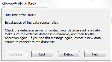

When I launch my task, this is the error I get in Excel:
This seems to be because the Power Query add-on hasn't fully loaded yet. This is my assumption for two reasons, #1, when I hit debug I can push "run" and it will finish the macro without issue (pushing debug seems to allow Excel to finish loading the add-on).  #2, I can see in the ribbon that the Power Query section isn't there when the error pops up, but it is there after I push debug.
I have also tried adding a delay, but the delay seems to also delay the add-on being loaded as well
Below is my code, any help is going to be great!
Thanks,
