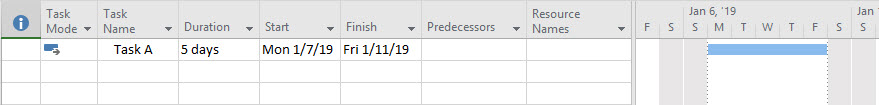

    A basic 5-day task without resources assigned, scheduled from 8:00 am (Project Start Date & Time) through 5 pm Friday, given the out-of-box Standard calendar definition (40 hours per weekday).

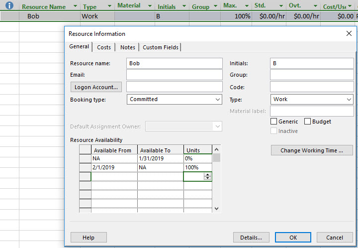

    Then a resource was identified and accounted for the project.  In this case, Bob.  But we were informed that Bob will not be available to the project until a later date, (February).  So we account for this 'delay' using the Resource Availability section of the Resource Information dialog.
    Now we assign Bob to the task, not knowing he's not yet available.  In a perfect world, we would ALL remember when our resources are NOT available.  Suppose we didn't, and we assign Bob to this task.  In one scenario or on some PCs, I see that Bob is assigned at 0%, and the task becomes a milestone since work is now 0%.
    Yet on some PCs, I'm seeing that the red overallocation indicator appears and the work remains at 40h as shown below.
    I understand the overallocation in this situation as Bob isn't available at that time to perform 40 hrs. of work.  I also understand that     work = duration x units.   I'm only asking for clarification as to why the inconsistencies between various PCs using MS Project 2016 Professional?  Is there a setting set on some and not for others?  What is the 'expected' functionality?  It's confusing as to why Project reacted one way on some PCs and another way on others.

    In your setup, you never set the resource to 0%.  He's 100% before and after the 1st of the month.  As a result, I can understand why you don't see what I'm seeing.
    I don't use dates on the 'From' on the first row, and 'To' on the second row as by default, they accept the start and finish of the project (project's date), therefore no restriction of time on both 'ends'.
    In your setup, please change the first resource availability row to 0%, then see the overallocation.  You may need to remove then add the resource again.

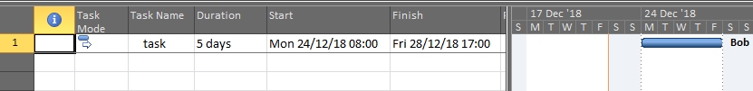

    I think you are incorrectly referring to the red man over-allocation symbol as the "task inspector".
    If I do what you say you do, I don't see what you say you see.
    The 5 day task is scheduled for Monday 24th, Tuesday 25th, Wednesday 26th, Thursday 27th, Friday 28th, like this. His unavailability doesn't even come into it.

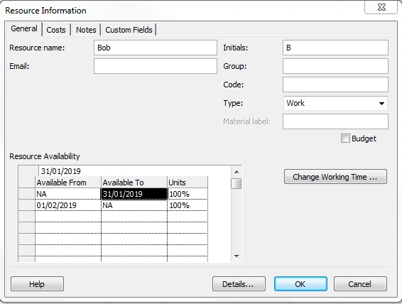

    The resource is available/unavailable like this. Why do you not have a from date on row 1 and a to date on row 2?
