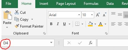

    You also said "I know I can use the find all option and read the location of each cell".
    The ActiveCell address is also displayed in the field to left of the Formula bar. See following screen shot
