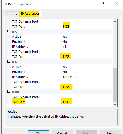

    • Please go to SQL Server Configuration Manager -> expand SQL Server Network Configuration->Protocols for InstanceName, make sure TCP/IP is enabled.
    • Then go to TCP/IP properties-> IP Addresses tab, make sure SQL Server instance is listening on port 1433 under TCP port. 120264-image.png
