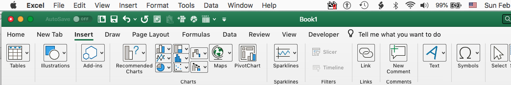

    The Select Objects tool exists in Excel 2019, but it does not work. I added it to one of my Ribbon tabs (it's on the right end of the ribbon shown below)
