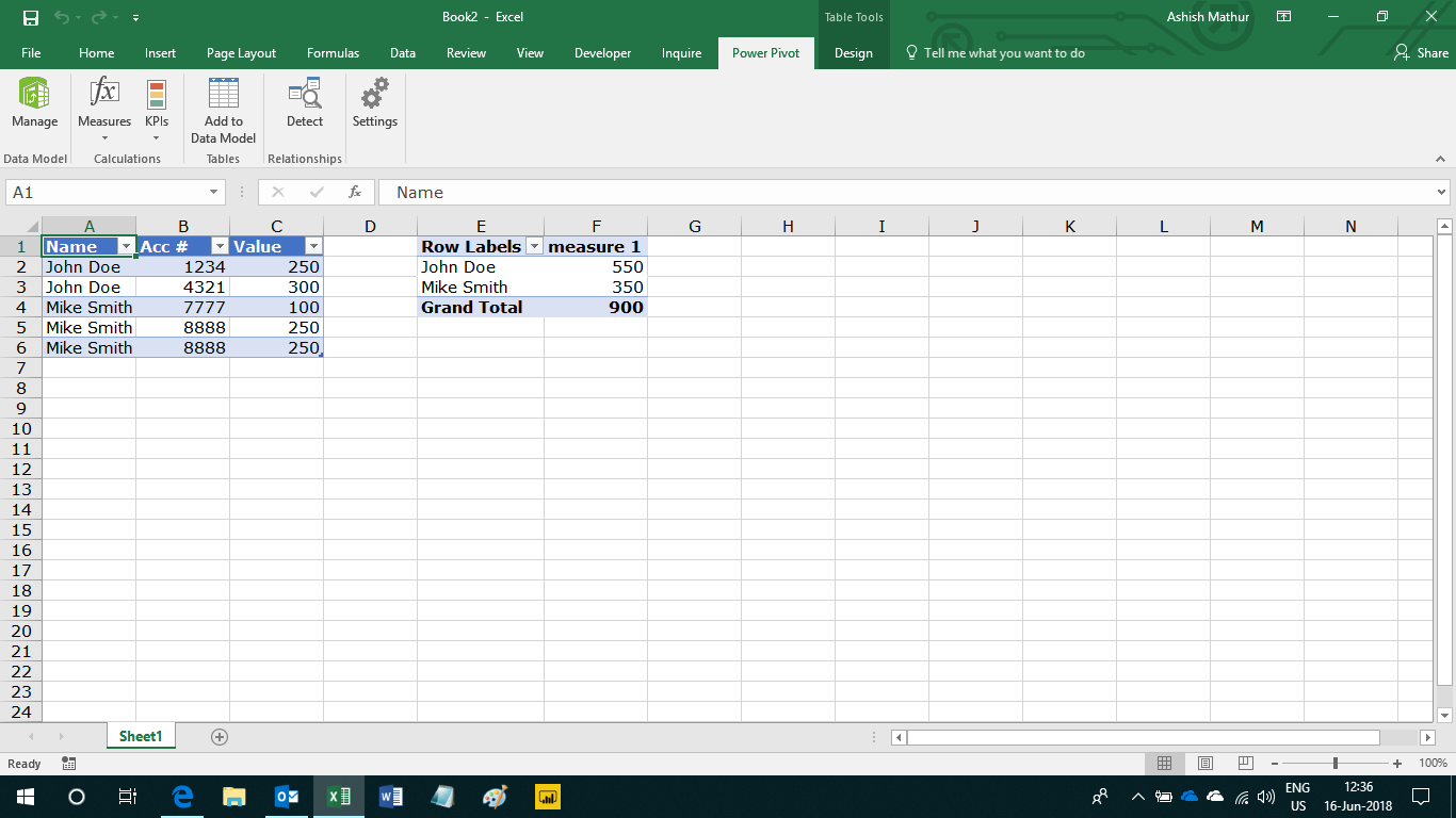

  1. Ashish Mathur 101.9K Reputation points Volunteer Moderator
    2018-06-16T07:06:34+00:00
    Here's the PowerPivot solution.  Try this measure
    =SUMX(SUMMARIZE(VALUES(Table1[Acc #]),[Acc #],"ABCD",MIN(Table1[Value])),[ABCD])
    Hope this helps.
