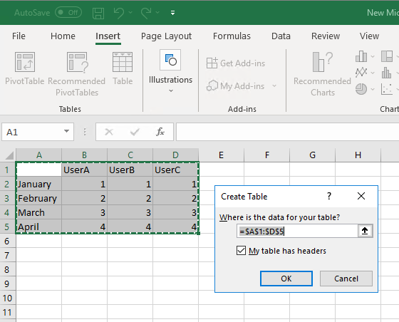

Hi Robert,
How about creating a table to make a chart with dynamic ranges? The following are some steps of my test:
1.Select your data and click Insert>Table.
2.After that, the table should be selected. And you can click Insert>choose a chart type.
3.Add a row in the table, you will find that the chart is changed automatically.
Hope it helps.

    Zixuan,
    Yes, that works! My data was not explicitly in a table so I first I created a table of the data, and now when I add or delete rows, the range being graphed follows the number of rows. Perfect!
    Thank you very much for your help! Such a simple solution for what was a complicated problem.
