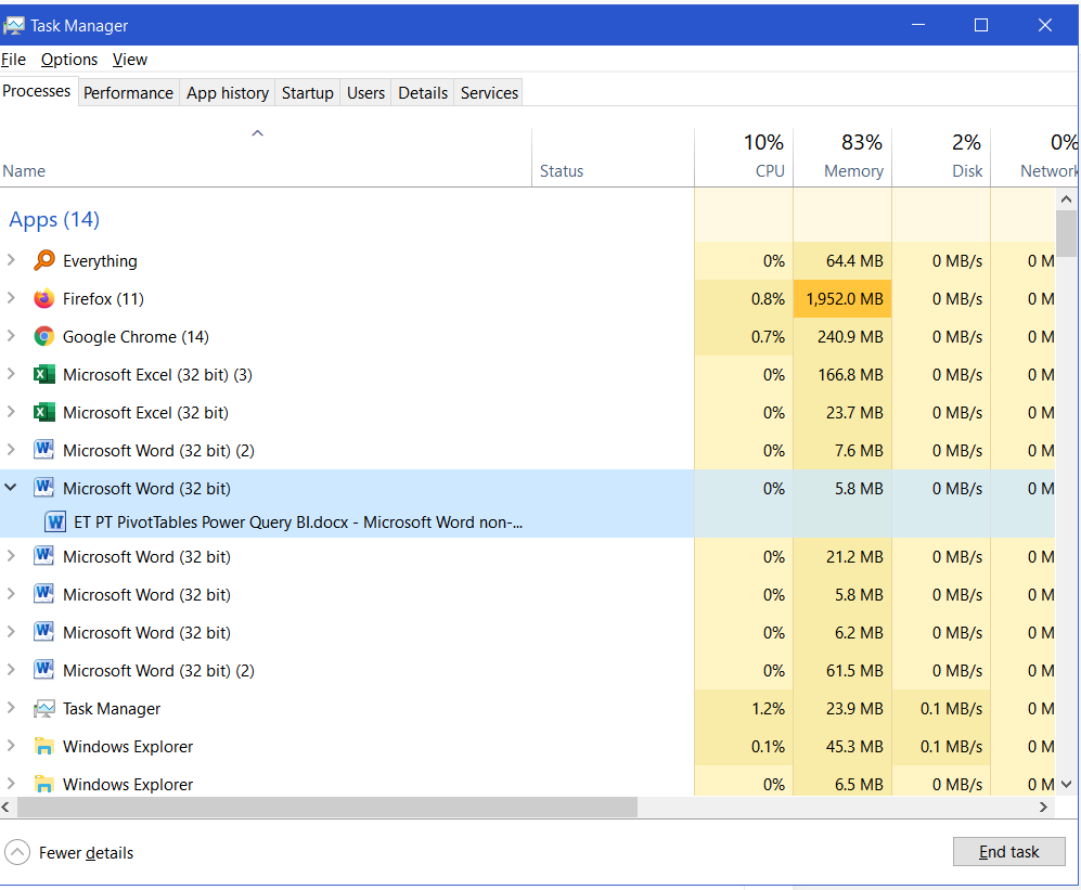

    In Task Manager you should see a new "MS Word" entry in task manager, where if you expand it, you'll see the appropriate file name.

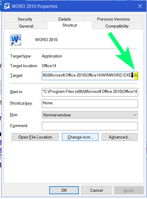

    You want to create a Word shortcut on the desktop
    At the end of the "target" in the shortcut, add /n to start a separate Windows "instance" of Word

    For a while now I've been running in to a problem where Word just "snap" disappears (often while doing the timed recovery saves!).  So if I had multiple documents open in the same Word "instance"/session, I would lose the changes in all of the documents. So, I setup a shortcut on the desktop with the /n switch, and use to start separate instances for all documents. It is a bit of extra work, compared to simply using the File / Open dialog. BUT, in the (not so) long run it has saved me more time not having to recreate unsaved changes. (And no, don't bother suggesting I use OneDrive).
