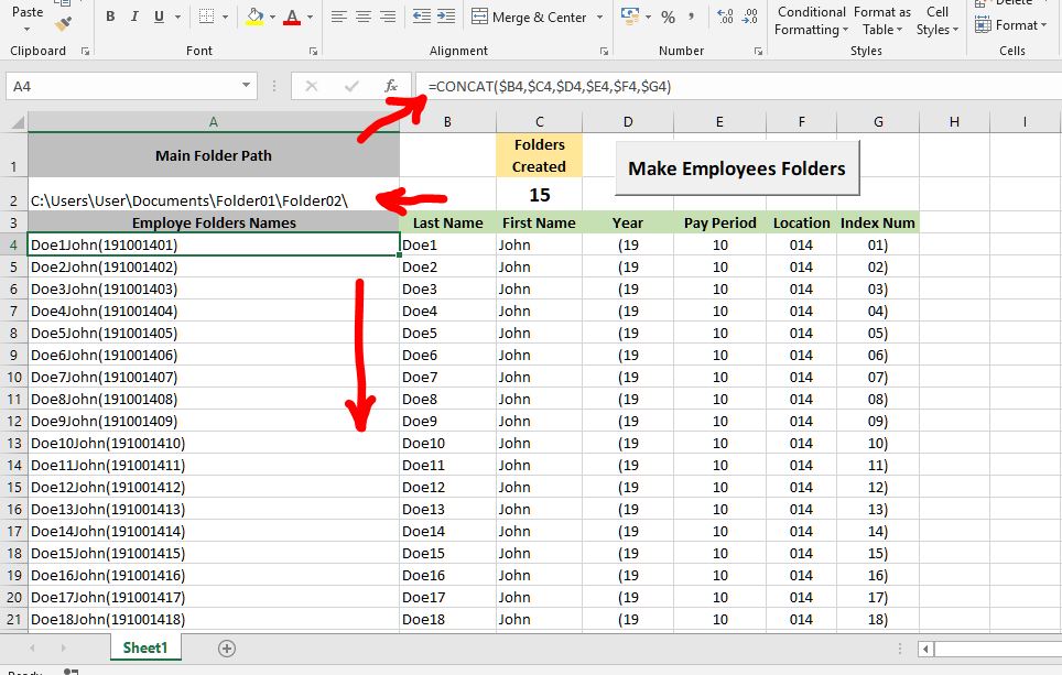

Hi Kala Sha Jahan
Please find in the link below a file containing my approach to find a solution to your problem
https://www.dropbox.com/s/j92a8l000ft83qmvs/MakeEmployeesFoldersWeb.xlsm?dl=0
Check picture below
