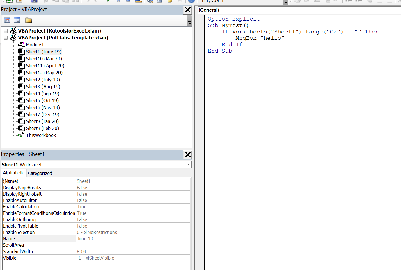

Starting a little project but have hit my first wall. When the Workbook opens I would like the code below to run but when it runs, I get a script out of range error and it highlights If Worksheets("Sheet1").Range("O2") = "" Then
Any thoughts on what the issue might be?

Sheet1 is the code name. Its sheet name is June 19. So use either
Private Sub Workbook_Open()
    If Worksheets("June 19").Range("O2") = "" Then
        MsgBox "hello"
    End If
End Sub
or
    If Sheet1.Range("O2") = "" Then
        MsgBox "hello"
    End If
End Sub

    I do have a sheet1 but am still getting the same error.

    Are you sure that you have a sheet named Sheet1?
    If so: sometimes the workbook isn't "ready" yet during Workbook_Open. You might try a small delay:
    1. Insert a new module and copy the following code into it.
    Sub MyTest()
            MsgBox "hello"
        End If
    End Sub
    1. Change the Workbook_Open event procedure to
        Application.OnTime Now + TimeSerial(0, 0, 2), "MyTest"
    End Sub
    This will run MyTest 2 seconds after the workbook has been opened. If that works, you can try changing 2 to 1 in the code.
