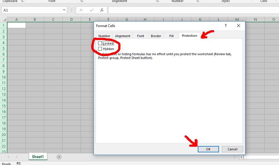

    1- Select rows from 1 to 60
    2-Go to Format cell > Protection and Unlock cells (uncheck)

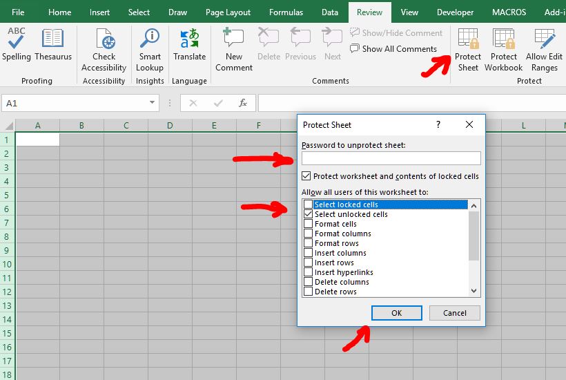

    3 - Go to Review > Protect Sheet > Select unlocked cells only
    Password is Optional
    This will lock all the cells above row 60 so when you reach that row from any column It will jump to the top of the next column (B1,C1,D1.....)
    Do let me know if you require any further help on this. Will be glad to help you.

    You must follow the same process from my post but this time select rows from 8 to 60.
    Regarding the other cells with info above row 8. You can do the same by selecting them individually.
    To move across unlocked cells press Tab or the arrow keys as well as the Enter key.
