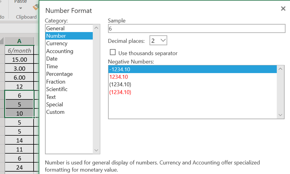

    I find a strange thing in this workbook, please kindly see the screenshot below:
    1.       Whatever decimal places settings I set, it only shows the integer number like 6, 5, 10.
    2.       When I click into the cell, put the mouse after the number, then press “Delete” button to clear something, then the number will show fine with the decimal settings. Then the number can be calculated fine with the formula.
    I think, we need to check where the data source is from. I assume the data is not created by typing manually. For example, it is from any data query or something else? If this is the case, we may find the root cause.
    Regards,
    Rena

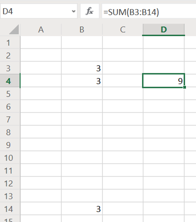

    Hi Caroline87sry,
    It works fine by my side. See the screenshot below
    Does the issue only happen to this specific workbook or all workbooks online?
    If the issue only happens to the specific one, you can try:
    1.       Create a new sheet, then copy and paste pure value then use formula to see the result.
    2.       Create a new workbook, then copy and paste pure value then use formula to see the result.
