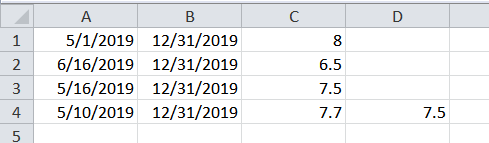

  5. Andreas Killer 144K Reputation points Volunteer Moderator
    2019-03-22T08:10:53+00:00
    There is no need for an IF, you can calcluate the result directly, see screenshot below.
    C1: =YEARFRAC(A1,B1)*12
    and drag down.
    If the days are not exactly at the half of a month (as you can see in row 4) you can round the result to the nearest of a half or full month:
    D4: =MROUND(YEARFRAC(A4,B4)*12,0.5)
