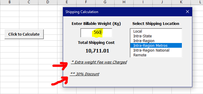

I have created a shipping cost calculator as per the shipping zone. I need to create a Macro for the same using User Form. I have already done but not able to get the calculation, I'm not very much familiar with VBA and using google help I created this much. Need help in completing it. You can either use the table reference or make a complete build - Calculator as given in the reference.

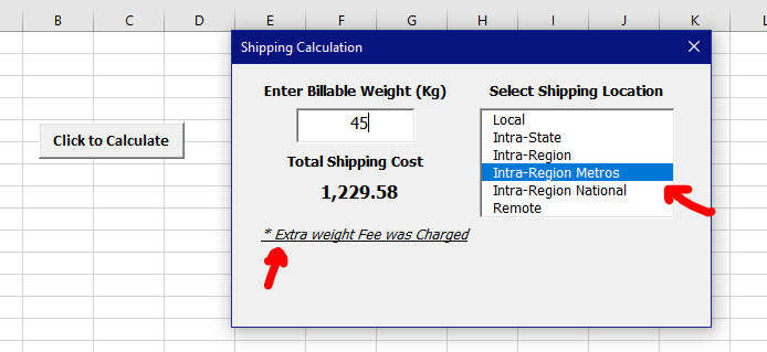

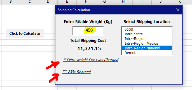

    Thank you very much, Jeovany.
    It works perfectly. I used the drop down box and you made it more simple by adding a list box.
    The C5 & C8 cells are used with excel and not VBA. In the original file, I had a box to enter the value and then calculated using the VBA code. Which calculated through the range of cells. I wanted to avoid that step, as the main calculation sheet needs to be hidden.
    Jeovany. there is small change needed.
    After we enter the billable weight and change the shipping zone it gives the shipping cost. And when we change the billable weightagain without changing the shipping zoneit does not calculate unless we change the shipping zone.

  4. Andreas Killer 144.1K Reputation points Volunteer Moderator
    2020-01-15T11:02:24+00:00
    Option Explicit
    Dim C5 As Variant
    Dim ShippingZones As Variant
    Dim ShippingFeesMinCharge As Variant
    Dim ShippingFeesIncremantal As Variant
    Private Sub UserForm_Initialize()
      Dim Item As Variant
      'No idea where C5 comes from
      C5 = 0
      'Fill the Shipping defaults
      ShippingZones = Array("Local", "Intra-State", "Intra-Region", "Intra-Region Metros", "Intra-Region National", "Remote")
      ShippingFeesMinCharge = Array(110, 132, 165, 198, 242, 308)
      ShippingFeesIncremantal = Array(11, 13.2, 16.5, 19.8, 24.2, 30.8)
      'Fill the listbox
      For Each Item In ShippingZones
        Me.Shipping_location_Box1.AddItem Item
      Next
      'First zone as default
      Me.Shipping_location_Box1.ListIndex = 0
    End Sub
    Private Sub Weightinput1_Change()
      'Calculate the result when the weight changes
      Dim BillableWeight As Double, MinCharge As Double, Incremental As Double
      Dim ExtraWeight As Double, FuelSurcharge As Double, Discount As Double
      Dim Result As Double
      'Show an error in case of invalid input
      Me.ResultTextBox2 = "(invalid input)"
      If Not IsNumeric(Me.Weightinput1) Then Exit Sub
      BillableWeight = CDbl(Me.Weightinput1)
      If BillableWeight < 0 Then Exit Sub
      If Me.Shipping_location_Box1.ListIndex < 0 Then Exit Sub
      MinCharge = ShippingFeesMinCharge(Me.Shipping_location_Box1.ListIndex)
      'P5:  =IF(C5<10,"Yes","No")
      'R7:  =IF(P5="Yes",0,C5-10)
      'combined:
      '=IF(C5<10,0,C5-10)
      ExtraWeight = IIf(C5 < 10, 0, C5 - 10)
      'S9:  =IF(AND($Q$3=S$4,$R$7>0),($R$7*S$6),0)
      If ExtraWeight > 0 Then
        Incremental = ExtraWeight * ShippingFeesIncremantal(Me.Shipping_location_Box1.ListIndex)
      Else
        Incremental = 0
      End If
      'S11:  =S8+0.2*S8
      'S12:  =S9+0.2*S9
      'S13:  =SUM(S11:S12)
      'combined:
      '(S8+S9)*1.2
      FuelSurcharge = (MinCharge + Incremental) * 1.2
      'Q15:  =IF(AND(C5>99,C5<=499),0.25,IF(C5>499,0.3,0))
      If (C5 > 99) And (C5 <= 499) Then
        Discount = 0.25
      ElseIf C5 > 499 Then
        Discount = 0.3
      Else
        Discount = 0
      End If
      'S15:  =S13-($Q$15*S13)
      'S16:  =S15*1.15
      'combined:
      '=(S13-($Q$15*S13))*1.15
      Result = (FuelSurcharge - (FuelSurcharge * Discount)) * 1.15
      Me.ResultTextBox2 = Format(Result, "0.00")
    End Sub
    Private Sub Shipping_location_Box1_Change()
      'Calculate the result when the zone changes
      Weightinput1_Change
    End Sub
