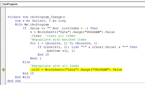

What I'm trying to do:  I have a userform combobox that I am trying to add some refined search functions to, but I don't know how to code VBA well enough to make that happen.
What I did:  I copied some code from a forum and modified it to my userform and controls.
What happened:  When I run the code, I get this error message -
When I click debug, it shows the highlighted line of code:
Any help would be very much appreciated.

  1. DaveM121 816.9K Reputation points Independent Advisor
    2019-12-19T20:30:45+00:00
    Hi Dana
    A runtime error 70 indicates you are accessing the same names object twice in your code . . .
    Set a variable at the top of your code to = Worksheets("Data").Range("PROGRAM").Value
    Then try setting V and .list to that variable
    If that does not resolve this, what is .cboProgram referring to?
    7 people found this answer helpful.
    2019-12-19T20:39:08+00:00
    I haven't tried the fix yet, but cboProgram is the name of the userform combobox that I'm trying to add search functionality to.  I'll try the fix and reply.
    Thanks.
    2019-12-19T21:13:34+00:00
    To Dana,
    Thanks for reaching out. This is Gems88 an Independent Advisor. I'd be more than happy to help you.
    Could you please comment out your current code in cboprogram_change and replace that with this code
    Dim v As Variant, i As Long
    Dim rangeval As Range
    Dim ws As Worksheet
    Set ws = ThisWorkbook.Worksheets("Data")
    With Me.cboProgram
    If .Value <> "" And .ListIndex = -1 Then
    v = ws.Range("Program").Value
    .Clear
    For i = LBound(v, 1) To UBound(v, 1)
        If LCase(v(i, 1)) Like "\*" & LCase(.Value) & "\*" Then
            .AddItem v(i, 1)
        End If
    Next i
    Else
    Me.cboProgram.Clear
    '.List = ThisWorkbook.Worksheets("Data").Range("program").Value
    For Each rangeval In ws.Range("Program")
    With Me.cboProgram
     .AddItem rangeval.Value
    End With
    Next rangeval
    End If
    End With
    Hope this one helps
    Regards,
    Gems88
