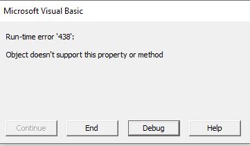

  1. I have a situation the User selects another workbook via FileDialog and assigns it to Public Workbook variable wbDestin  (Works perfectly)
  2. The code then loops through the Userforms and assigns the Userform Names to a ComboBox List. (Works perfectly)
  3. User selects a Userform from the ComboBox.   (Works perfectly)
  4. The code assigns the selected Userform to a VBComponent variable. (Works perfectly and Debug.Print establishes the correct Userform Name)
  5. The code then goes to the simple loop (between the asterisk lines below) and it will not loop through the controls in the Userform.
I will very much appreciate it if anyone can help me out with the code that is failing. I have no problem looping through controls in a Userform when I can use the actual Userform Name. My problem is when I am trying to use a variable for the Userform after selecting the required Userform from a ComboBox.
Private Sub cboUserForms_Change()   'ComboBox Change Event
    Dim vbCompFrm As VBComponent       'Used for the Userform Component
    Dim Ctrl As MSForms.Control                 'Used in the for Each Loop where I am having the problem
   'Following line assigns the Userform to a VBComponent Variable  (Me.cboUserForms.Value holds the Userform Name)
    Set vbCompFrm = wbDestin.VBProject.VBComponents(Me.cboUserForms.Value)
    Debug.Print vbCompFrm.Name      'This returns the correct Userform Name
    For Each Ctrl In vbCompFrm.Controls     '<---This line fails. See Screen Shot below
        Debug.Print Ctrl.Name                       'This line used to simplify the code example for this forum
    Next Ctrl
End Sub

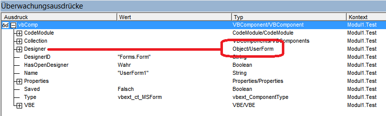

  1. Andreas Killer 144.1K Reputation points Volunteer Moderator
    2019-04-30T08:31:53+00:00
    I always try all of the Intellisence DropDown
    Hint: Use the watch window and explore the type of the variables, then you can find it easier:
    Andreas.
