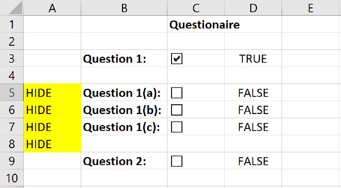

When I 'group' or 'hide' checkboxes (form control) some of them can been still be seen.
I understand that you need to use VBA to make them invisible.
I have an example and I was wondering if anyone could solve my problem - I have a questionnaire where if the answer to Question 1 is 'True' then I want to hide questions Questions 1(a), 1(b) and 1(c).
How would I be able to use VBA to solve this problem?
Here is the questionnaire example:

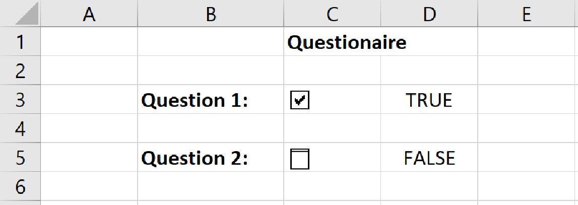

Here is what I would like the result to be (Questions 1(a), 1(b) and 1(c) are hidden):

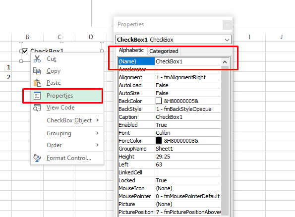

    When you put the code. please replace "CheckBox1.Value = True" to the name of your checkbox. To get the name of your checkbox, right click on it and select properties. you will be able to see the name. (see screenshot). Then make sure to copy the name and replace it on your code in Module 1
    Let me know if you need more help.
