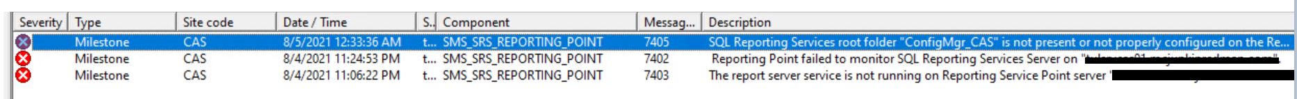

Receiving the below message for the "SMS_SRS_REPORTING_POINT" Role.
SQL Reporting Services root folder "ConfigMgr_CAS" is not present or not properly configured on the Reporting point server "adatum.contoso.com".
Reporting Point failed to monitor SQL Reporting Services Server on "adatum.contoso.com".
Component Status Summarizer set the status of component "SMS_SRS_REPORTING_POINT" running on computer "adatum.contoso.com" to Warning.

Component Status Summarizer detected that component "SMS_SRS_REPORTING_POINT", running on computer "adatum.contoso.com", has reported 1 or more Error status messages during the Component Status Threshold Period.
Possible cause: The count equals or exceeds the Component Status Warning Threshold (1 status messages) for Error status messages for the component.
Solution: If the component's status is not already set to Warning, Component Status Summarizer will set the component's status to Warning in the Component Status summary in the Configuration Manager Console.
The report server service is not running on Reporting Service Point server "adatum.contoso.com"; start the service to enable reporting.
Please help to solve the issue.
No errors found in the Program Files\Microsoft Configuration Manager\Logs\srsrp.log
