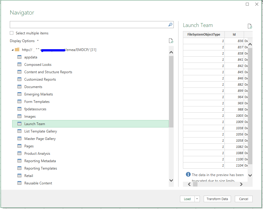

I can get to the SharePoint Folder using and see my filer but Binary is not available so I cant open it
I have tried going to  the Base folder and changing SharePoint.Table to SharePoint.Files but only a short list appears and then then there is an error which may be causing the list to stop or this may be a red herring
I have also tried changing the API to 14 from 15 but i get a different list which then makes it impossible for me to locate my file.

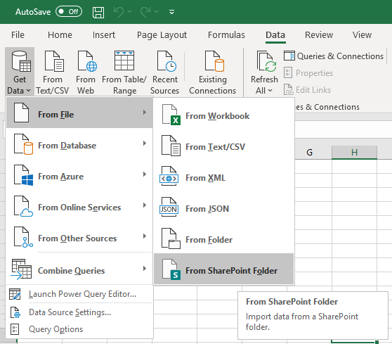

    I tested on my end and I could see the files and content was listed as Binary. To access the SharePoint folder in Excel, I used Data tab, then clicked Get Data>From Folder File> From SharePoint Folder, as shown in the screenshot below.
    When a prompt appeared to enter the address, I put in https://tenant.sharepoint.com/sites/SiteName and once it was connected, I could see the files.

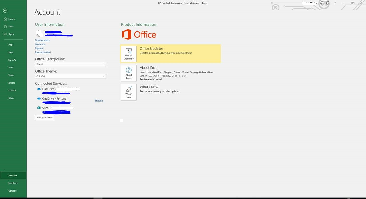

    1. Please provide us with a screenshot of Office 365 Product Information. To get this screenshot, open any Office app such as Word or Excel on your system, click File>Account, capture the screenshot of all the information mentioned under Product Information. (Note*: please remove any sensitive information from the screenshot such as email address or full name etc.).*

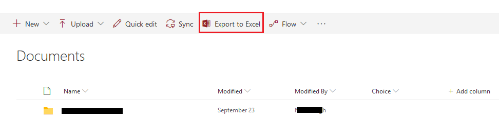

    In addition, you can consider using Export to Excel option available in SharePoint online list/library.
    For detail steps, see Export to Excel from SharePoint

    I think there is an typo in your response I used Data tab, then clicked Get Data>From Folder> From SharePoint Folder I think you meant From File as From Folder is not an option for me here.

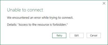

    If I use this start point then I get this message – maybe this is the issue, I will check with our IT.

    1. As requested please see screenshot below

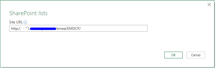

    My method for getting the data is:
    Get Data>From Other Sources>From SharePoint List
    I then select Transform Data and start to navigate through to the files on SharePoint

    Regarding the issue, first thing I’ll suggest you update your Office applications, your Office version is behind some updates. The latest version of Semi-Annual Channel is Version 1902 (Build 11328.20438).
    To know how to install updates, see Install Office updates

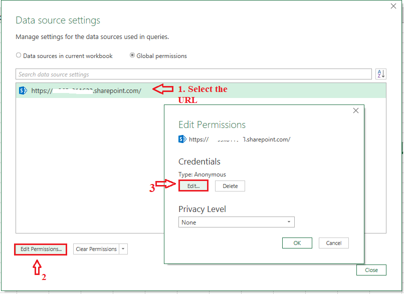

    Once Office is updated, try performing the steps I mentioned in my last post, also the steps which you tried, check if either of that works. If you still get “Unable to connect Details "Access to the resources is forbidden" error, follow the steps below to rectify:
    1. In Excel, click Data>Get Data> Data source settings.
    2. Select on the site URL then click on “Edit Permission” in the Data source settings page.
    3. Click on Edit.
              4. A new window will open, select Organizational account Or Microsoft Account on the left pane and click Sign in.
              5. Pick an account and double click on it (sign in with your work or school account, if required).
    Now, you can try again, and you should not receive the error.
    In addition, in my last post I provided the link to Export to Excel from SharePoint, you may try this method, see if this works for you.
