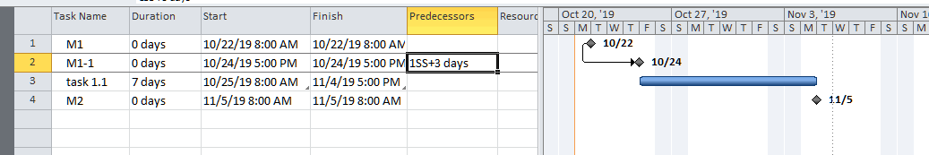

    It's still not clear as to exactly what you are trying to achieve. It sounds like you want task 1.1 to start a fixed amount of time after the M1 milestone and finish at the M2 milestone such that as M1 and M2 move, task 1.1 will track. And for that to happen, you do indeed need paste links but the implementation to achieve that is a little more complicated.
    First of all, you cannot have both a paste link and a predecessor with lag on the start date of task 1.1. Those two are mutually exclusive. However, you can achieve the above with an intermediate milestone such as is shown in this example. The intermediate milestone, M1-1 picks up the start delay while milestones M1-1 and M2 are used for the paste links to drive the duration span of task 1.1.

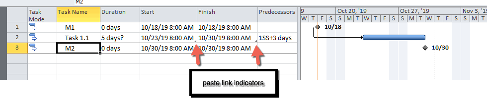

    I tried the scenario you describe and I did not have the issue of a progressive loop. This is how I set it up according to your description, except I used a lag of 3 days instead of 36 mons,
    However, it makes no sense to have a paste link on the start of Task 1.1 if you also have a start-to-start predecessor with a lag. Use one or the other, but not both.
    The Wiki article about paste links I cited in your other post mentions the fact that paste links are fragile. I can't stress that enough. Paste links should only be used as a last resort and then only used sparingly.
