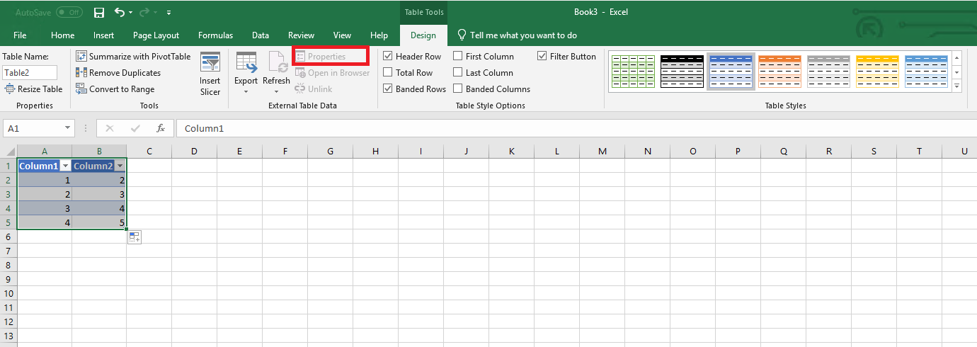

    If you create a simple table in Excel 2016, Table Style Options and Table Styles should appear. For the issue please upload some related screenshots for our reference. Meanwhile, I suggest you go to Control Panel>Programs>right-click on the Office 2016 applications’ icon>Change>Online Repair, restart the computer and then do a test to see the result. Moreover, upload a full screenshot of the  Account page in Excel 2016 for our reference. You can access the page via File>Account.
    Note: Remove any private information before uploading the screenshots.

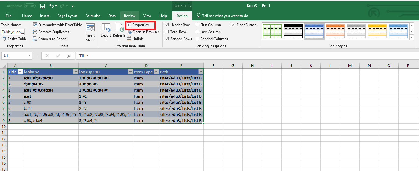

    For the Properties option, it is only enabled when you get the table from an external data source such as a SharePoint Online list. If the table data isn’t from an external data source, the option is greyed out by default.
