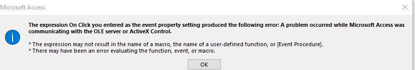

Access error message: problem communicating with OLE server or ActiveX control
2019-08-17T00:06:25+00:00
See below. How can I fix this in Access 365 Code Builder?

    Umm Mark, Of course my response didn't resolve the problem. How can you expect anyone to resolve the problem without seeing the code that is causing the error?
    Did you copy and paste that code from the editor? If you did I see one problem right off the bat.
    Set OutLookApp = CreateObject("outllok.application")
    outlook is misspelled!
    There is also another error in this line
    .ReminderTime = Me.Duedat - 3 & " 8:00 AM"
    Shouldn't that be Me.Duedate?
    The rest of the code looks OK. Fix those problems and see if it works.

    Here is the entire code I got from a youtube video.
    Option Compare Database
    Private Sub Add_Task_to_Outlook_Click()
    Dim OutLookApp As Outlook.Application
    Dim OutlookTask As Outlook.TaskItem
    Set OutlookTask = OutLookApp.CreateItem(olTaskItem)
    With OutlookTask
        .Subject = "Reminder for Task:  " & Me.TaskName
        .Body = "This is a reminder from Access 3 days before due. Task name: " & Me.TaskName & " is due on " & Me.Dutedate
        .ReminderSet = True
        .DueDate = MeDueDate
        'remind 3 days before task due
        .ReminderPlaySound = True
        .ReminderSoundFile = "C:\folder\file.wave"
        .Save
    End With
        MsgBox "Task has been set in Outlook successfully. " vbInformation, "Set Task Confirmed"
    End Sub

    Hi Mark, I'm an independent adviser and will try to help.
    However, to help I need to see the code behind the button you are pressing. The error message tells you that something is wrong with the code. But it doesn't specify what. So we need to see that code.
    Please copy and paste the code into a response so I can try to help.
