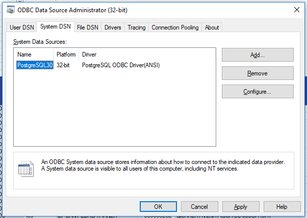

I've been having a problem to import a database from Postgresql in Excel from a ODBC Driver. I have installed the following:
  • PostgreSql - 32bits
  • PostgreSql ODBC Driver - 32bits
  • Office 365 Pro Plus - 32bit
  • Windows 10 - 64bit

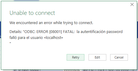

The error that shows after I try to get Data by an ODBC connection is the following:

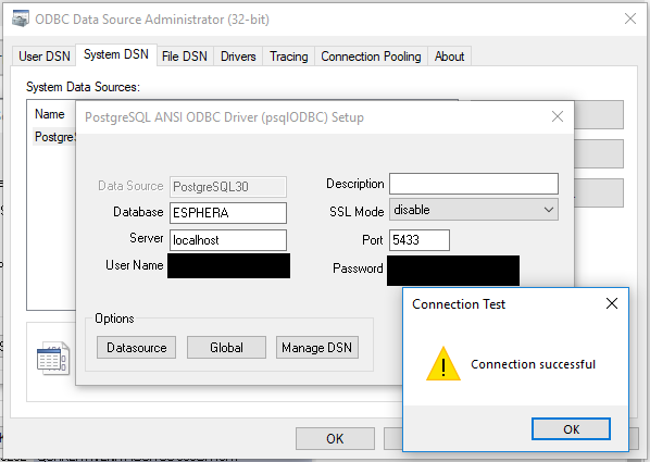

It didn't Actually ask me for user or password but I had Installed the ODBC Driver (32 bit) and tested the connection and it was successfull.

    Hi Andres,
    Thanks for sharing your experience with us.
    Regarding the authentification error when connecting PostgreSQL database in Excel, you may try following and see if it will help:
    1.Refer to the Note inthis article and make sure you have installed the Ngpsql data provider for PostgreSQL installed on your computer
    2.Click Data tab>Get Data>Data Source settings>Clear Permissions.
    3.Or try running Excel in safe mode, then connect to the PostgreSQL database again.
    Please also ensure to use the latest version of Office. Click File>Account>Update Options>Update Now, see if there is any update available.
    If issue persists, please help confirm the following information. Appreciate your time and effort.
    1.Please share with us a full screenshot of Product Information via File>Account.
    2.What are your detailed steps before getting the error message.

    2019-06-27T16:59:17+00:00
    Thank you Tina,
    The second one solved my issue perfectly. The error was that I confused the username by the server.
