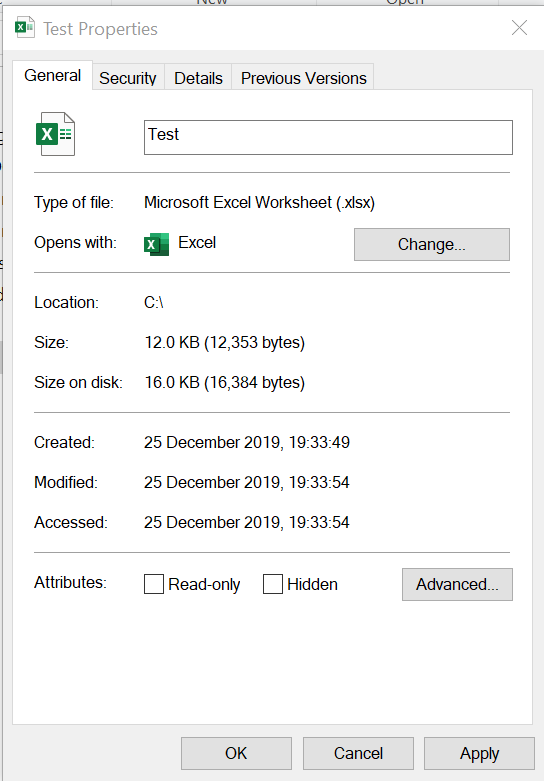

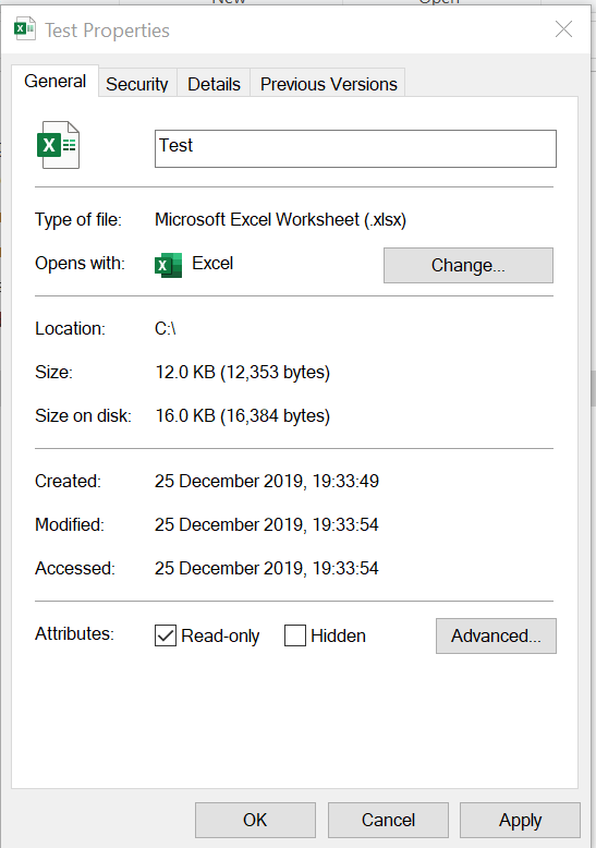

    I tested the code and it worked for me.
    Please describe the steps you are taking to reset the attribute.
    I created Test.xlsx in C:, set it to Read Only in File Explorer, added your code (just changed .xls to .xlsx) to a new Excel file and ran the code... it removed the Read Only setting...
    BEFORE Running the Code
    AFTER Running the Code
