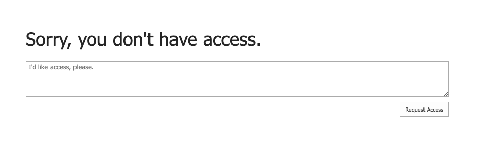

Hi there,
I am having an issue where I am unable to access popularity trends for my site, despite being its creator and an owner. I am wanting to use this to see some analytics for my site.
When I click into it, it says that I do not have permissions. However, when I request access, my own email address is contacted. When I approve the request, I am still unable to access popularity trends.
Does this mean that I must be a Site Collection Admin or even a Global Administrator to access this?

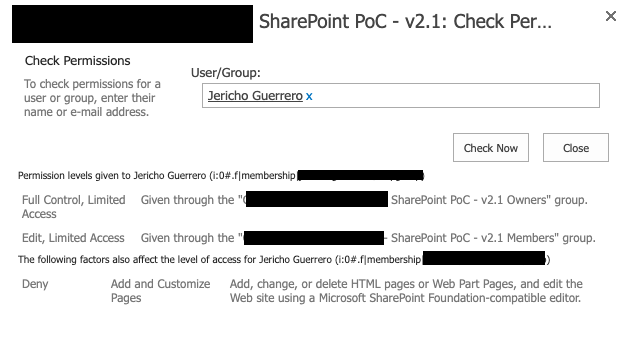

    2019-03-26T22:32:39+00:00
    Hi Jericho,
    Generally, with full control permission for a site, we will be able to access the popularity trends for the site.
    The permission page you provided before indicates you don't have Add and Customize Pages permission for the site, so I suggest the tips above to enable custom script.
    However, to run the related command to enable custom script for the site, it requires to use SharePoint admin account or Office 365 global admin account. If you are not the admin, you may need to contact admin and enable it for you.
    For your reference: Allow or prevent custom script
    Please feel free to let us know if you are able to access popularity trends for the site after enabling custom script. We will help you do further troubleshooting.

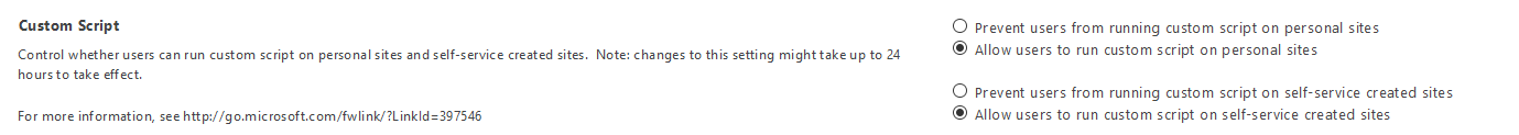

    2019-03-23T13:31:50+00:00
    Hi Jericho,
    Thanks for getting back to us and sharing the detailed information.
    If you are a SharePoint online global admin, you may try following to enable custom script and see if it will fix the issue:
    1.go to SharePoint admin center>Settings>Custom Script, if the two options are set to Prevent, select Allow for both as below:

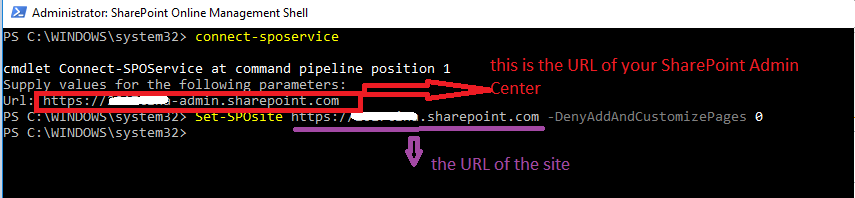

    2.Install SharePoint Online Manage Shell and run the following commands:
    1. connect-SPOService -Url https://contoso-admin.sharepoint.com -credential ******@contoso.com
    Note:
    a.the URL is your SharePoint Admin Center URL: https://contoso-admin.sharepoint.com
    b.The credential is SharePoint online global admin's credential.
    1. set-SPOsite <SiteURL> -DenyAddAndCustomizePages 0
    Note: the SiteURL is the URL of your site.
    If may take 24 hours for the settings above to take effect.

    2019-03-22T03:36:39+00:00
    Hi Tina,
    1. Yes, I only get the error message about not having access after I click Popularity trends. Below is the error that I see:
    1. Below is a screenshot of the results of checking my permissions.
    1. I do not believe that this is a site specific issue, as I have created two separate sites that both come across the same issue.
