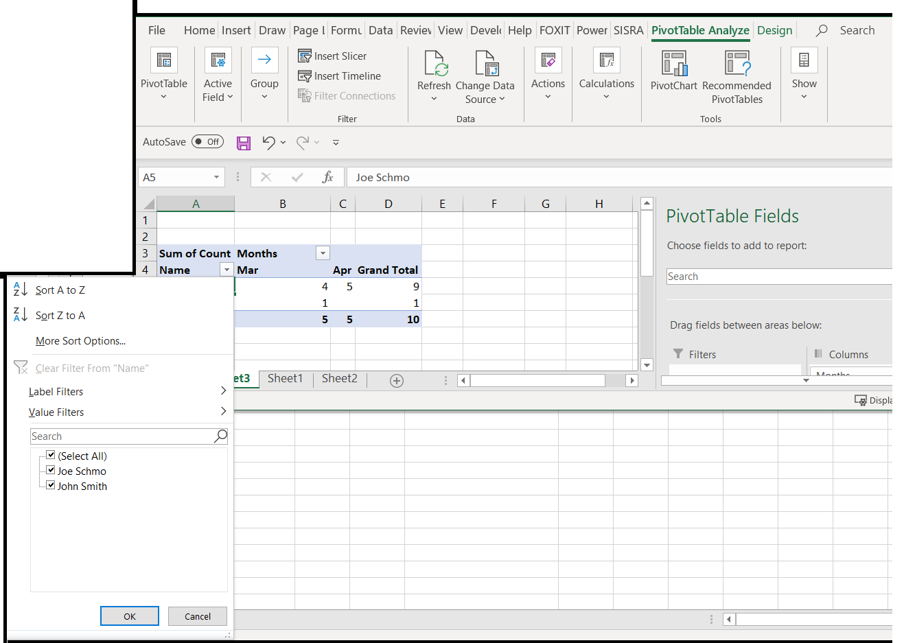

    Yes I am aware of pivot tables and that is fine but I want to create a dashboard that displays a Line Chart based on a drop down list. So if I select John Smith on the drop down, the Line Chart will display that data. Essentially I want something that works like the following images:

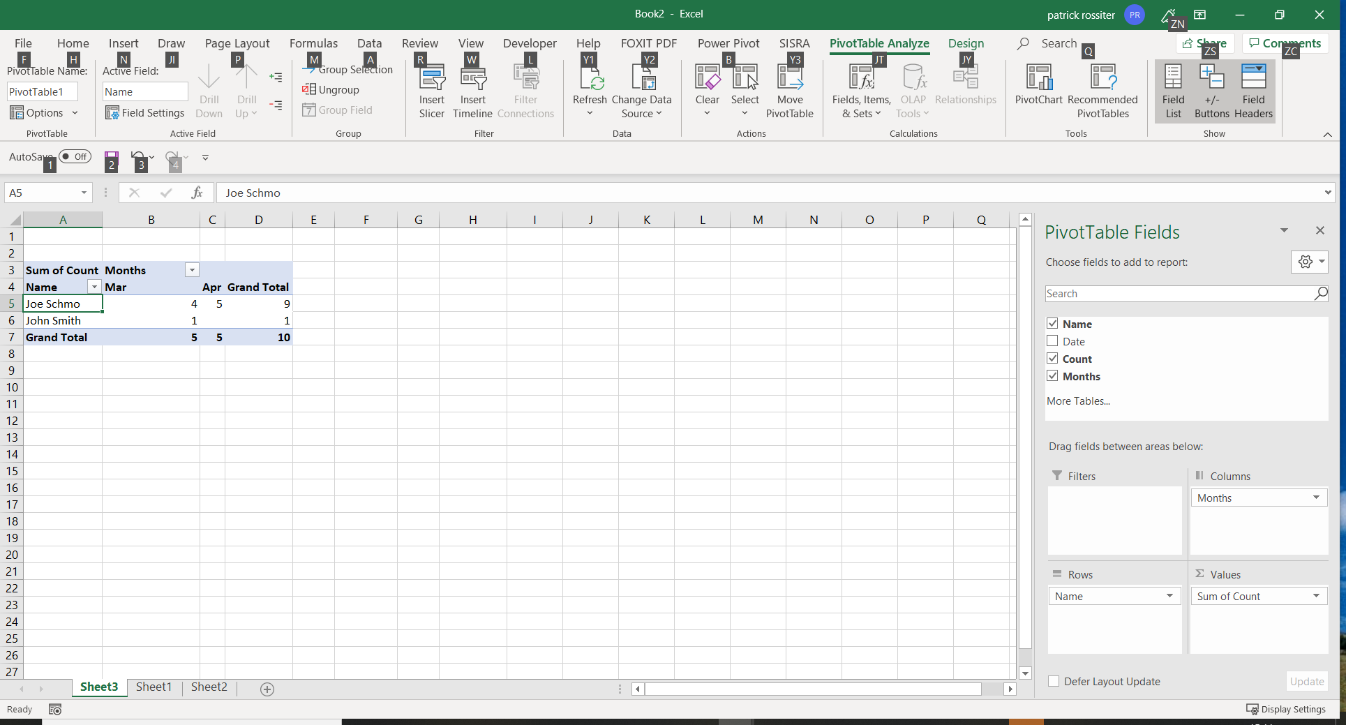

    Hi Adam
    Do you know anything about pivot tables?
    I think you will find a solution using Pivot Tables.
