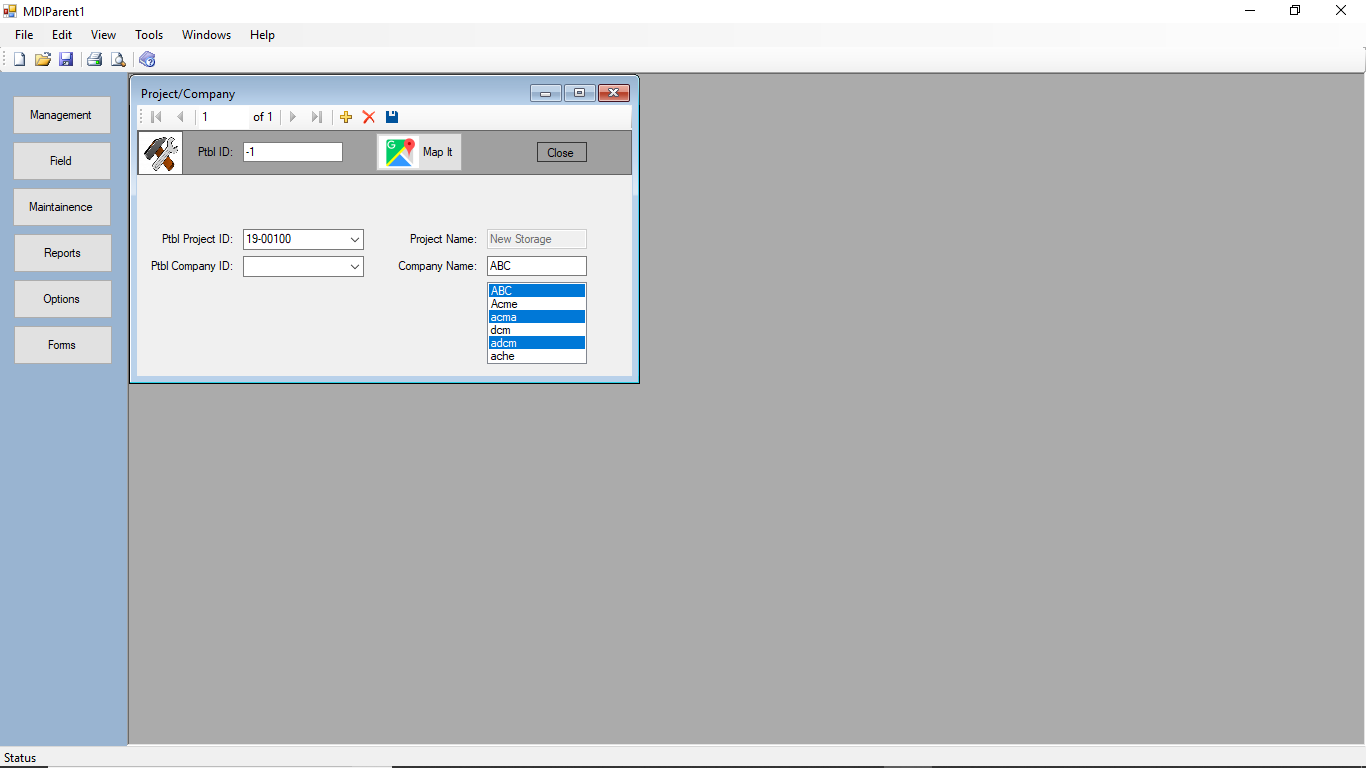

I have a form above.  the short of my question is:  I want to select a project # from dropdown, then select multiple companies from list box.  and have them added to the table.  ie… project#, company#.  I have a table for projects and 1 for companies, I have set up a table for linked projects/companies to keep records in.  you can have multiple companies involved in 1 project.
could someone please help with this?
my code is:

    2019-04-23T18:08:27+00:00
    I have the project combobox populated from the projects db and the company list box populated from the company db.
    what I want to do simply be able to use my small form and select a project then select company(s) from the list box.  click the add button and have only the selected items added to a 3rd db which I have created.  it has projectID and companyID in it.  I just store the ID's for later use lookup
    in construction, we have a job and on the job there are several to many subs.....
    so my logic is to be able to select 1 project and multiselect subs.  so to say...….
    to link them to the job.
    does this make sense??
