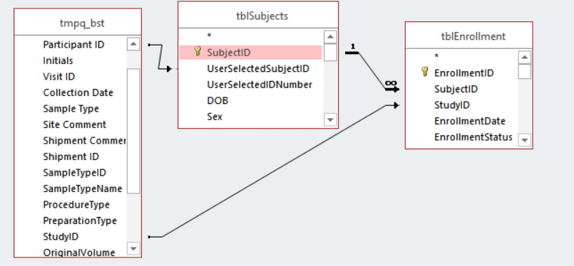

    I tried to construct the query graphically to see what SQL Access would generate:

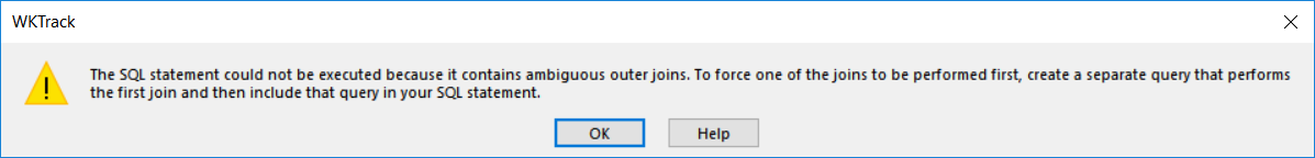

    No dice:
    The message does suggest a work-around....

    The columns involved are keys (subjectid even has a key icon in the tblSubjects in the screenshot) although admittedly not the key for tblEnrollment.  StudyID is the key to tblStudies, which tmpq_bst references, although it does not appear in the diagram.
    But why does it matter whether the fields are keys?  I'm unaware that SQL required the fields to be keys.  Is that an Access-specific restriction?
