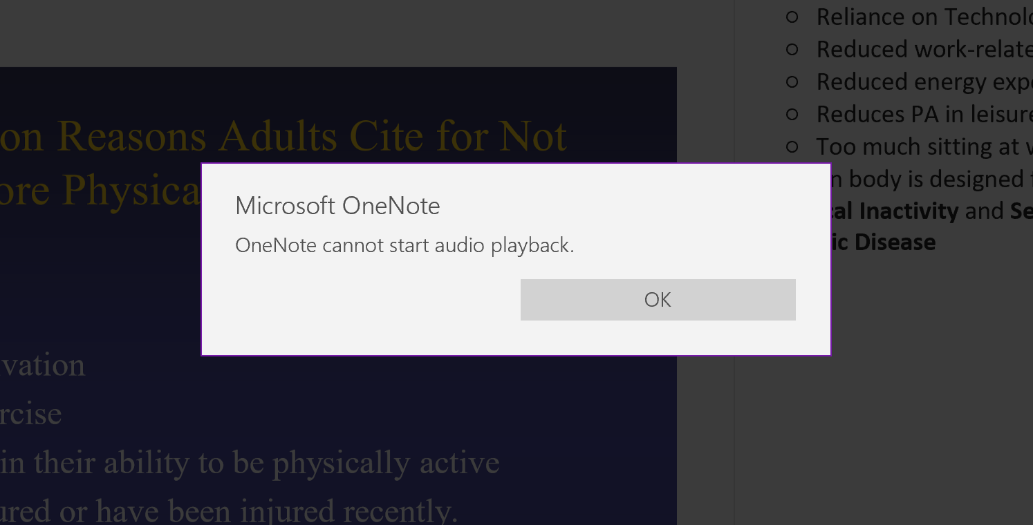

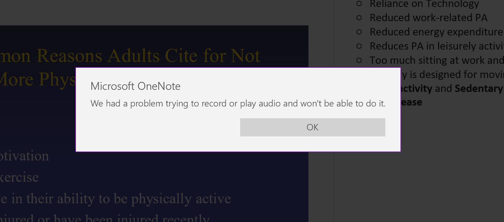

I have been using OneNote for a long time now to record my lectures and then listen to them later. I recently changed my computer to a surface book 2. After having recorded in class yesterday I was able to listen to my notes by playing them back from the speakers of the laptop but once I connect my Bluetooth headphones, it stops being able to playback the audio and instead gives me these messages. As soon as I disconnect the headphones it starts to work again.
Why is this issue happening and what can I do to fix it?

    The issue: Audio files recorded and saved on OneNote for windows 10 display the following error messages only when playback is done while a Bluetooth audio output is being used :
    1. OneNote can not start audio playback. ;
    2. we had a problem trying to record or play audio and won't be able to do it.
