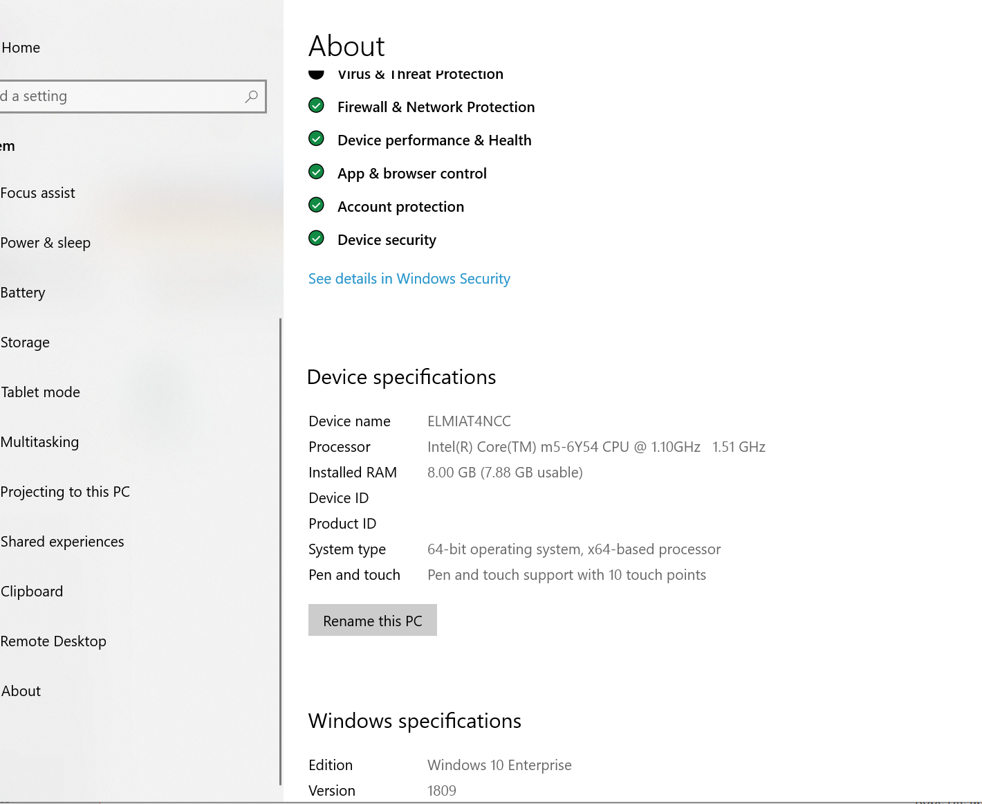

    Still having the issues. Below are the answers to your questions.
    May I know if you are using OneNote for Windows 10? YES If so,  you can go to Settings > About and provide the screenshot of it. If you are using OneNote for Mac, you can go to OneNote > About OneNote to provide the screenshot of it.
    May I know if all notebooks have the same problem? You can create a new notebook to check if the same problem will occur. Yes they all have the same problem and I have also created a new book and it has the same issues.
