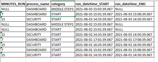

This is the output that i am hoping to get. (it is in desc order)

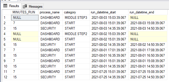

    ;with cte as (
    SELECT *,COUNT(CASE category WHEN 'Start' THEN 1 END) OVER (PARTITION BY process_name ORDER BY recid) AS Grp
    FROM cs_process_log
    WHERE category IN ('Start','End'))
    ,cte1 as (
    SELECT process_name,run_datetime, category,
           MAX(CASE category WHEN 'Start' THEN run_datetime END) over (partition by process_name,Grp) AS run_datetime_start,
           MAX(CASE category WHEN 'End' THEN run_datetime END) over (partition by process_name,Grp) AS run_datetime_end
    FROM cte
    union
    SELECT process_name,run_datetime,category,run_datetime,NULL
    from cs_process_log
    where category not IN ('Start','End'))
    select distinct DATEDIFF(MINUTE,run_datetime_start,run_datetime_end) MINUTES_RUN,
    process_name,category,run_datetime_start,run_datetime_end from cte1
    where category<>'end'
    order by run_datetime_start desc
    Output:
