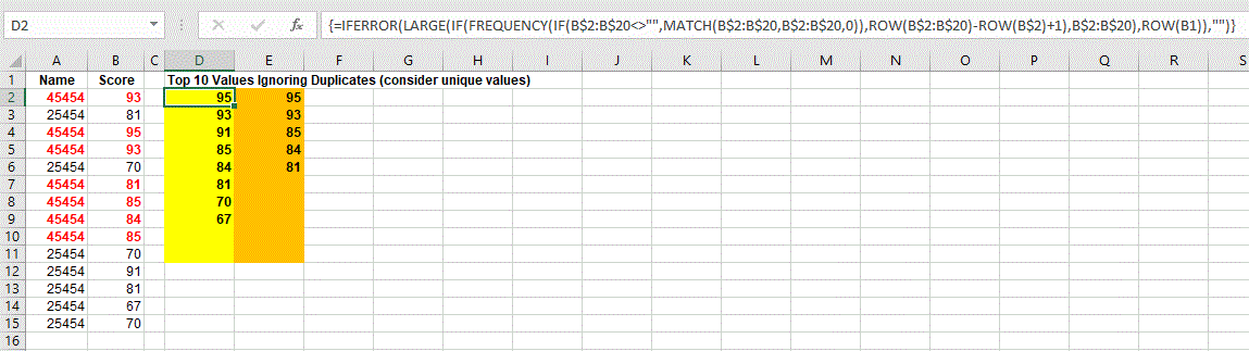

    2019-07-10T06:31:41+00:00
    Enter below formula as an array formula (Ctrl+Shift+Enter) in cell D2 and copy down till D11 - this returns the Largest 10 values from column B:
    =IFERROR(LARGE(IF(FREQUENCY(IF(B$2:B$20<>"",MATCH(B$2:B$20,B$2:B$20,0)),ROW(B$2:B$20)-ROW(B$2)+1), B$2:B$20), ROW(B1)),"")
    Enter below formula as an array formula (Ctrl+Shift+Enter) in cell E2 and copy down till E11 - this returns the Largest 10 values from column B where column A = 45454:
    =IFERROR(LARGE(IF(FREQUENCY(IF(A$2:A$20=45454,MATCH(B$2:B$20,B$2:B$20,0)),ROW(B$2:B$20)-ROW(B$2)+1),B$2:B$20),ROW(B1)),"")
    Regards,
    Amit Tandon
    www.excelanytime.com
    http://twitter.com/AmitTandonExcel

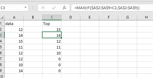

  1. Deleted
    2019-07-09T19:28:33+00:00
    For example:
    C2=MAX(A2:A9)
    C3=MAX(IF($A$2:$A$9<C2,$A$2:$A$9))
    Drop down the formula will works.
    2019-07-09T19:51:07+00:00
    Thanks it seems to be working but I have one more item to add.
    I have account numbers in column P.  For example, a box in column P with account # 45454.  I need it to pull the top 10 amounts for that account only (45454.
    With the previous formula you provided it will pull top 10 amounts in the entire column.  The amounts in this column are pulling from all difference account numbers.  Just need it to separate and pull top 10 for each account number.
