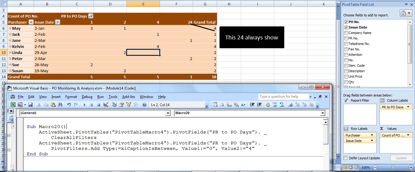

I use Record Macro to filter PivotTable "PR to PO Days" field label filter between 0 and 4. When i record, it can filter correctly, only show 1, 2 & 4. But when i run the macro, it is not filter correctly, 24 which is should not show always show.

    I know the answer. Remove " " from the number 0 & 4. Else it is treated as text not number.
    2019-03-14T01:29:51+00:00
    Thank you for your help. Because i want to modify the coding the values filter in between are variable (numbers key in by users at cells). So i cannot know what's the values are to filter.
    2019-03-13T18:07:51+00:00
    try this....
