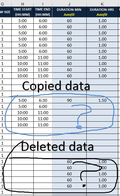

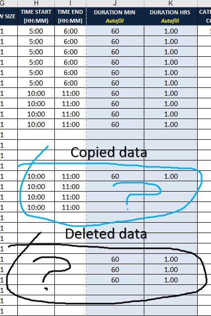

    Thanks for your response.
    It worked but not completely responsive. When the entries are entered in columns H and I only that row gets updated. If several lines of data are copied over to H and I, then the outcome shows up only on the first row (blue circle), the rest (below) show blank. Also, when the entry data is deleted (black circle) the results in columns J and K still show and not removed. Please see below the image of the spreadsheet when I use your code. Thank you.
    https://learn-attachment.microsoft.com/api/attachments/9b94ff28-8f9f-4b2e-adac-1f121e4d0f66?platform=QnA

    Alec,
    Up to this point it was one row at a time.
    In my view you enlarged the scope.
    Here you go...
    Note:  rngCell is rngCell(1, 1)
              code searches thru Column 9 (I)
              rngCell(1, 0) is in column H
              rngCell(1, 3) is in column K
    '2nd revision
    Private Sub Worksheet_Change(ByVal Target As Range)
    On Error GoTo BadEntry
      Dim rngCell As Excel.Range
      Dim rngAll As Excel.Range
      If Target(1).Column < 8 Or Target(1).Column > 9 Then
        Exit Sub
      Else
        Set rngAll = Application.Intersect(Target.Cells.EntireRow, Me.Columns("I"))
        For Each rngCell In rngAll.Cells
           If rngCell(1, 0).Value = vbNullString Or rngCell.Value = vbNullString Or _
              rngCell.Value < rngCell(1, 0).Value Then
              rngCell(1, 2).Value = vbNullString
              rngCell(1, 3).Value = vbNullString
           Else
              Application.EnableEvents = False
              rngCell(1, 2).Value = (rngCell.Value - rngCell(1, 0).Value) * 1440
              rngCell(1, 3).Value = (rngCell.Value - rngCell(1, 0).Value) * 1440 / 60
           End If
        Next 'rngcell
      End If
    Application.EnableEvents = True
    Exit Sub
    BadEntry:
      VBA.MsgBox Err.Description & " - " & Err.Number
    End Sub
