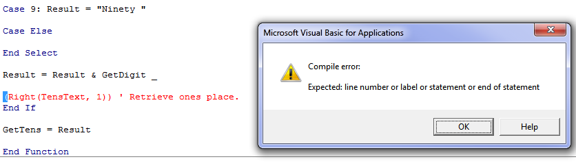

I had set up a template with the SpellNumber function in Excel 2010, which worked just fine.  When attempting to use it in Excel 2013, I receive the following syntax error:
The function was created using the steps in
https://support.office.com/en-gb/article/Convert-numbers-into-words-a0d166fb-e1ea-4090-95c8-69442cd55d98
I can't seem to find information on how to correct this.
5 answers
  1. HansV 462.4K Reputation points MVP Volunteer Moderator
    2019-04-05T18:31:13+00:00
    The underscore in the offending line was intended to be a continuation character, and the rest of the line should have been on the next line.
    Remove the underscore _ to get rid of the error.
    40 people found this answer helpful.

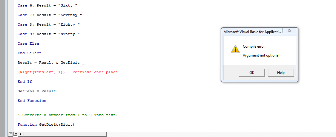

    2019-04-18T18:00:36+00:00
    Thank you.  That seems to have removed one error, but not I'm receiving the following "Argument not optional" error:
    I'm at a loss.  Please let me know if there is a way to correct this, or whether there is another function code I should be using to convert numbers to words.
    Thanks.
    23 people found this answer helpful.
  3. HansV 462.4K Reputation points MVP Volunteer Moderator
    2019-04-19T08:54:57+00:00
    Please remove the empty line below the line in red.
    13 people found this answer helpful.
    2019-04-24T18:01:48+00:00
    Unfortunately, this did not solve the problem.
    14 people found this answer helpful.
  5. HansV 462.4K Reputation points MVP Volunteer Moderator
    2019-04-24T18:31:24+00:00
    Sorry, my mistake. Remove (delete) the empty line between
    Result = Result & GetDigit _
    and
    (Right(TenstText, 1)) ' Retrieve ones place.
    88 people found this answer helpful.
