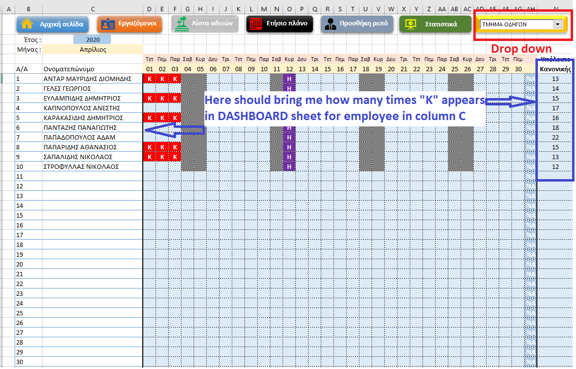

Here is a picture of my project, it is in Greek but I added some comments to help.

    The image I show on original question has column C with employees' names and also I have a drop down which I select a department and the list shows me only employees from specific department.
    The firt picture shows where my result should be and how I filter my employees list

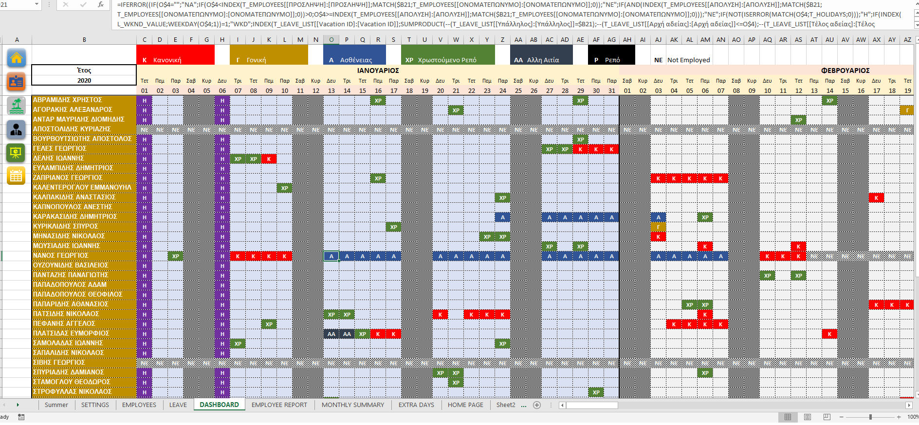

    The second picture is DASHBOARD sheet, it is very long as it contains 365 days.

    Dashboard sheet :
