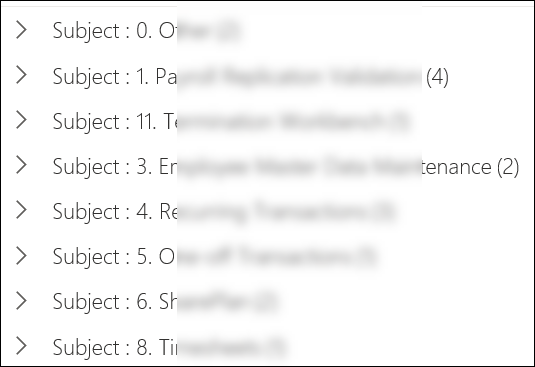

I'm on a client site and have been given a complex doc library to manage. Everything is nested in multiple folders so I'm wanting to demonstrate the virtues of using tags, sorting and grouping which makes library content easy to find. However I'm finding that if I have a list of subjects starting with a number (this is something I inherited) that if I sort the list in subject order, it doesn't display in numerical order, which is kind of clunky - note that Subject 11 appears before 3:
So, I created another field - a sorting field named Subject# which is a number field  - with just the subject number in it, and set the list to sort by this field, but group by Subject.  But after doing that, it still sorts in non-numerical order as above (note that not all the subjects are populated yet).
Any tips? It seems such a simple and obvious thing to be able to do, but looking around at posts on this it seems a long-standing problem with SharePoint sorting.

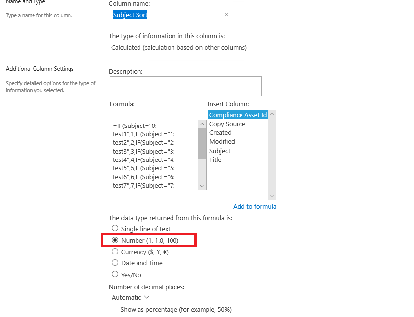

    Based on your description, I guess that you create a site library like the following. The Subject column is a choice type column with eth choice selections
    0: test1, 1: test2, 2: test3, 3: test4, 4: test5, 5: test6, 6: test7, 7: test7, 8: test8, 9: test9, 10: test10, 11: test11, 12: test12.
    If yes, I suggest you create a calculated column naming Subject Sort to achieve your requirement. You can type the formula like the following and set the value as number.
    =IF(Subject="0: test1",1,IF(Subject="1: test2",2,IF(Subject="2: test3",3,IF(Subject="3: test4",4,IF(Subject="4: test5",5,IF(Subject="5: test6",6,IF(Subject="6: test7",7,IF(Subject="7: test7",8,IF(Subject="8: test8",9,IF(Subject="9: test9",10,IF(Subject="10: test10",11,IF(Subject="11: test11",12,IF(Subject="12: test12",13)))))))))))))

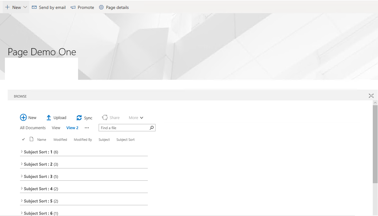

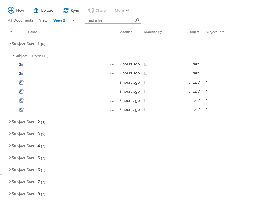

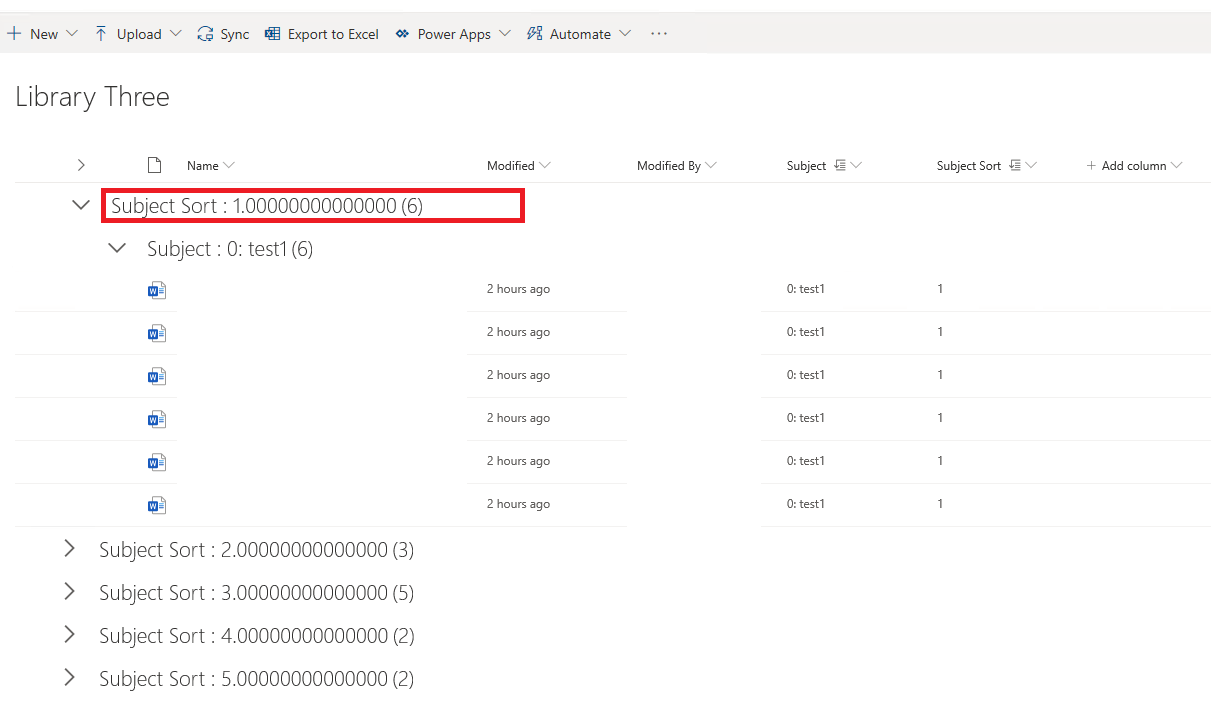

    Then group the Subject Sort column and the Subject Column. The view may be showed with some little problem when using the modern SharePoint UI. I suggest you use the classic SharePoint UI. If you want to use some modern web parts on the modern site page, I suggest you use the Embed web part with the code as follows to embed the classic page on a modern page as well.
    The modern SharePoint UI.
    The classic SharePoint UI.
