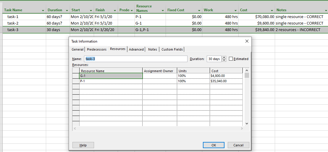

I have a task for 1 resource named P-1, with a resource cost of $146.00 USD. The task has 480 hours of work.
Project calculates the total cost as $70,080.00 which is correct.
I have a task for 1 resource named G-1, with a resource cost of $20.00 USD. The task has 480 hours of work.
Project calculates the total cost as $9,60.00 which is correct.
My third task is where the calculation is incorrect as explained below.
My task 3, with 2 resources, P-1 used for 60% and G-1 used for 40% displays a cost of $39,840.00 which is incorrect. The real cost should be $45,888.00.
Resource sheet is below. Yes they are over-allocated.
Task entries showing costs below
Task information showing the units below

You haven't assigned the resources at 60% and 40%. You have assigned them both at 100%. Each has 240 hours of work at their respective rates.
I checked it with a pencil and paper. It's all correct.
How did you assign the resources to the task? Did you use resource, assign resources?

    2020-02-09T16:15:17+00:00
    Hi Trevor,
    I just did a test by creating a new project.
    Opened the Resource Sheet and entered the resource name and standard rates.
    Opened the Gantt view and created a task with 480 hours.
    Went to the Resource> Assign Resources and chose the 2 resources and applied the 40% and 60% units.
    You already know the outcome. :-)
    A CORRECT calculation!
    Thank you for leading me to the solution.
    I do have a workflow question as a result of this learning.  Should I never do the assignments and units splitting directly in the Gantt Resource Names column? I realize the Assign Resources will derive the correct calculation, but I can't see a reason why the direct entry method is any different.  The final inputs in the Resource Names column look identical, but there must be some jiggery-pokery going on behind the scenes.
    2020-02-09T13:23:23+00:00
    Hi Trevor,
    The resources are now assigned at 60% and 40%.
    Still incorrect amounts.
    I assigned the resources while in the Entry view of the Gantt/Tasks view.
    Is the way I did it incorrect?
