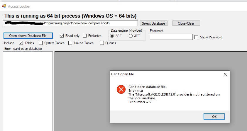

    I've downloaded the access database engine you showed me above - I used the 64 bit one. I did it many times but it does not seem to help, the issue still occurs. Is there anything else I need to do after? I have forced it to 64 bit CPU, but noticed that when I run the programme, the header of the window mentions x86??
    Also, in your first reply, you suggested I download the access looker - I did this but when I tried to run it the same error message appeared as the one in visual studio - Is this to do with the access database engine issue above?

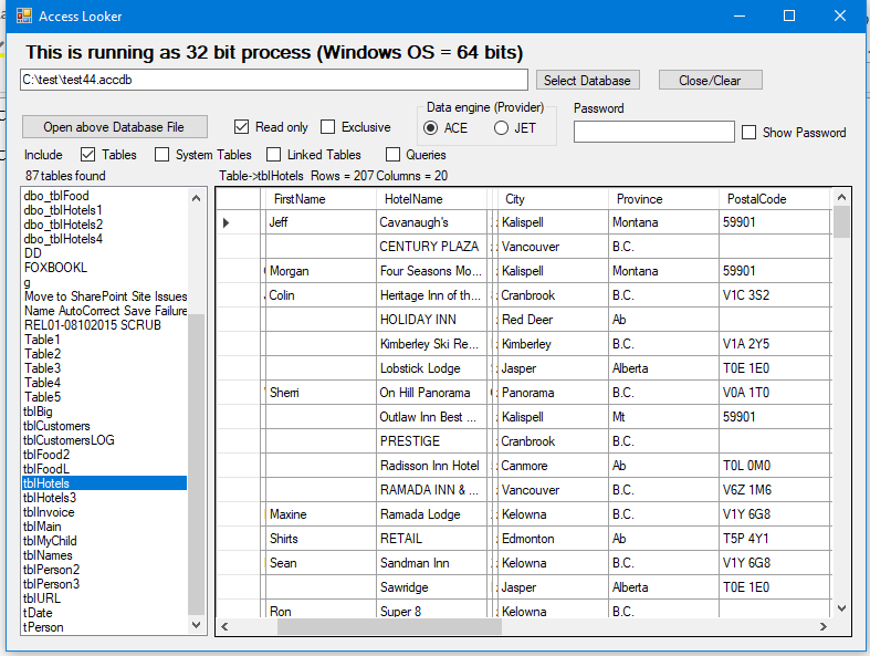

    It looks like this:
    Note how it states x32 bits.
    So there are two small .exe. One for x64, and one for x32. You can simply run it, browse to a accDB file (or mdb), and hit Open Database file.
    This will allow to you test/check if you have a working copy of ACE that works with .net

    And you can take 50 seconds - try the above sample zip. It has a x32, an a x64 bit compiled tiny .exe. Run both - see which one works and you instant know if you have a working copy of ACE that .net can consume.
