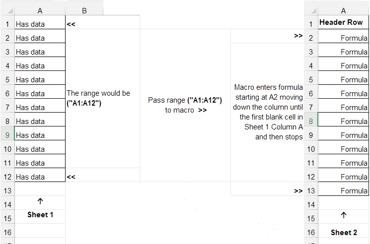

How I would like it to work is the macro finds the first and last cells with data in “Sheet 1” Column A and use that to specify the range on “Sheet 2” Column A into which to enter the formula copied down the number of rows identified by the range from “Sheet_1”.
So if “Sheet 1” Column A has data in Cells A1 – A100 then the VB macro with enter the formula in “Sheet 2” Column A Cells A2 – A101 and the formula should auto number the numeric references in the same way that it would if it was copied down manually. Sheet 2 has a header row hence the one row offset (A2 – A101). Just to clarify that at any one time the number of cells in Column A "Sheet_1" with data can vary from 1 cell to 1000 cells or more.
This is a screen shot of a mock up of the way the macro should work but I am open to betters ways of reaching the same result.

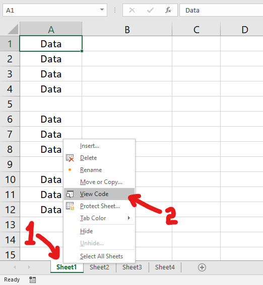

    Using the worksheet change events you could achieve your goals without the need of inserting and clicking a button to run the macro.
    The following codes will run each time Sheet1 is activated (selected) or deactivated
    Please,
    1- Right-click on the Sheet1 tab
    2- Select View Code
    3-and paste the following codes on the sheet events VBA panel

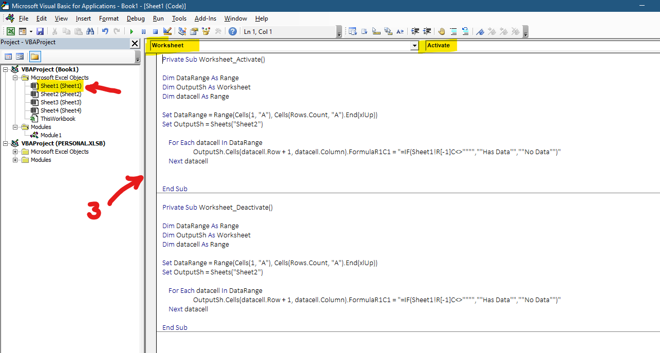

    Here is the code
    Private Sub Worksheet_Activate()
    Dim DataRange As Range
    Dim OutputSh As Worksheet
    Dim datacell As Range
    Set DataRange = Range(Cells(1, "A"), Cells(Rows.Count, "A").End(xlUp))
    Set OutputSh = Sheets("Sheet2")
        For Each datacell In DataRange
                        OutputSh.Cells(datacell.Row + 1, datacell.Column).FormulaR1C1 = "=IF(Sheet1!R[-1]C<>"""",""Has Data"",""No Data"")"
        Next datacell
    End Sub
    Private Sub Worksheet_Deactivate()
        Next datacell
    End Sub

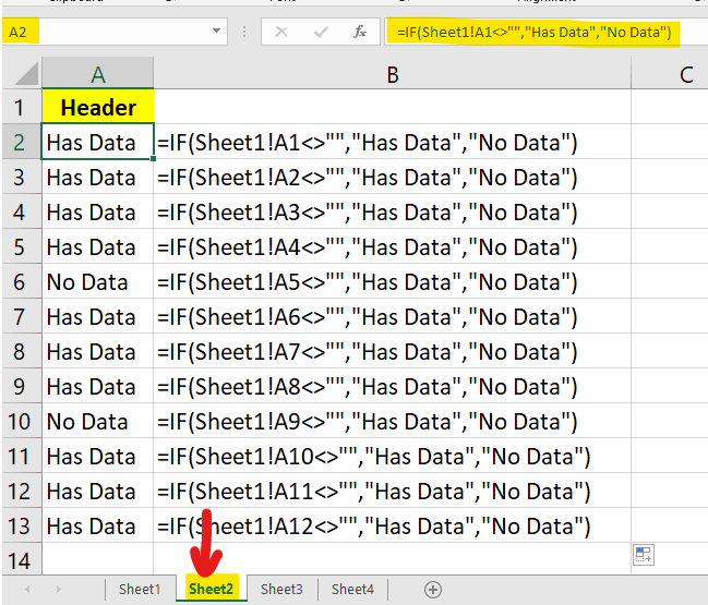

    RESULTS
    On Sheet2, Column B shows the formulas in column A
